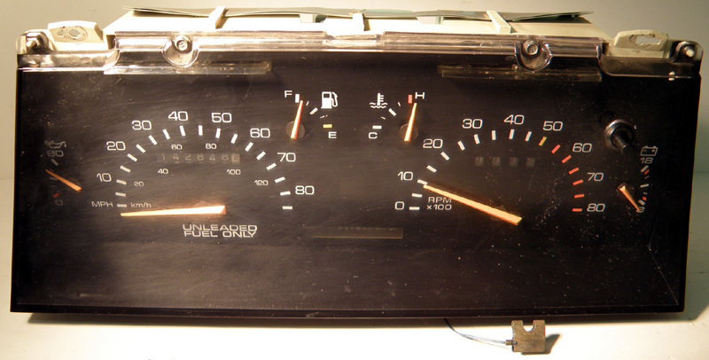

My '90 turbo 'T-Type' 'Retta came with analog gauges. I didn't like the orange needles in the standard clusters, particularly since my car is blue with blue. The top cluster in the picture shows the grey needles in my original cluster, on top, with a stock digi-dash cluster at the bottom, and a digital Z-24 cluster I modified for the Beretta in the middle.
Top: My '90's analog cluster, grey needles, blue LED lighting.
Middle: Z-24 semi-digital cluster modified for my 'Retta.
Bottom: Stock Beretta digital cluster.

Either way, the old Beretta cluster is semi-back-lit too, for the numbers, tic-marks, and secondary gauges. Note the needles there are opaque though, just like the early Berettas' are.
