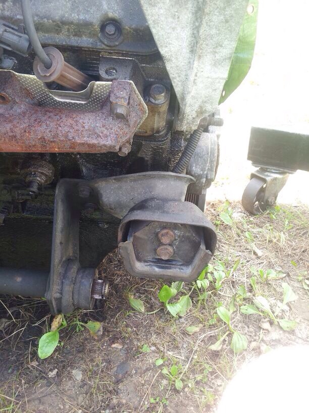

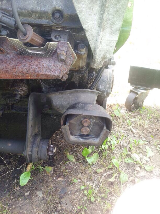

checking rock auto, it lists a rear 5 speed mount but no 5 speed front mount. Is there a possibility that the mount that connects to my custom mount is the same and only the rear mounting bracket is different?
The brackets I have just posted in the WTB would it be possible these are the same on a 3.1 5 speed cavalier or where they L body specific
EGR exhaust manifold block off bolt
This mounting bracket defiantly looks different than mine this is out of a 5 speed beretta a friend of mine has
The automatic mounting bracket only fits though one of the holes on the jack shaft
Will see if he can find one at the junk yard but I am not going to hold my breath

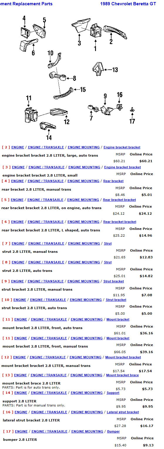

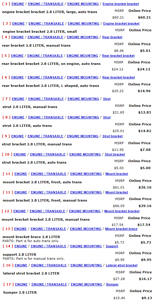

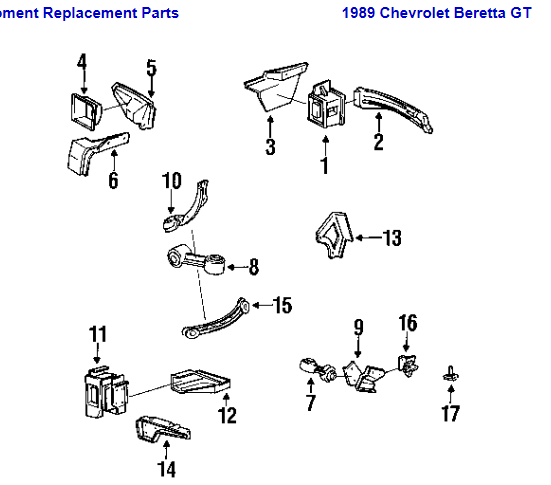

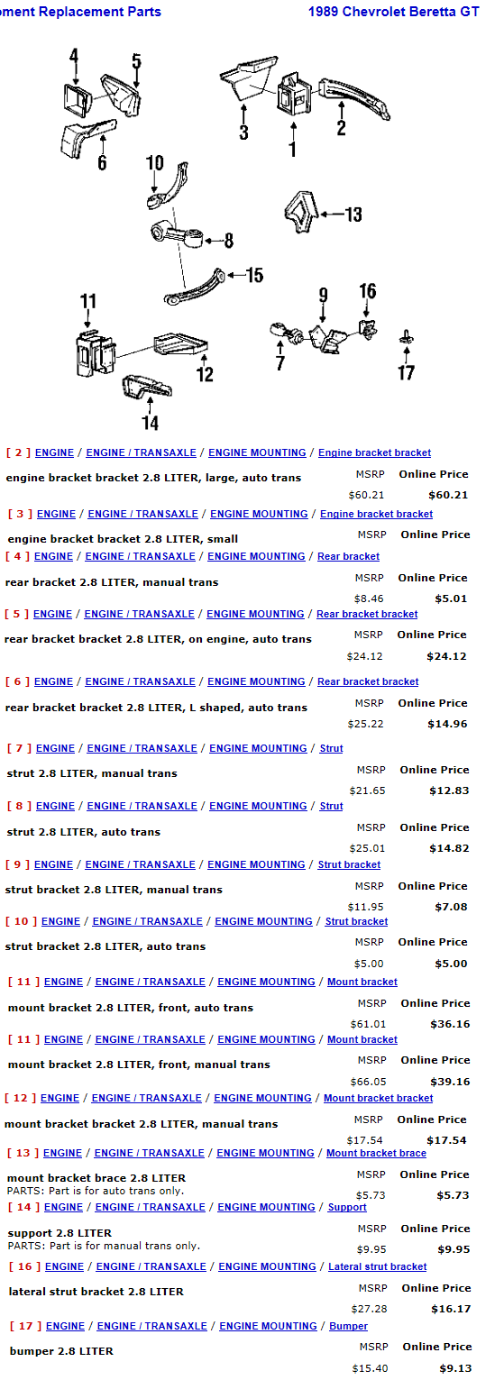

Quick ref to 'otc' parts that require drivetrain option in selecting of replacement parts:
1989 CHEVROLET BERETTA 2.8L Manual Transmission Mount
ANCHOR Part # 2603
1989 CHEVROLET BERETTA 2.8L Automatic Transmission Mount
ANCHOR Part # 2601
1989 CHEVROLET BERETTA 2.8L Engine Motor Mount
ANCHOR Part # 2477
(Rear Right; 3 speed trans)
ANCHOR Part # 2708
(Rear Right; 5 speed trans)
It will not list brackets as a replacement item since it's not an expendable part, however, you should be able to call a GM parts clerk and cross reference the brackets #'s
I've attached what I currently could find on the interwebz.
