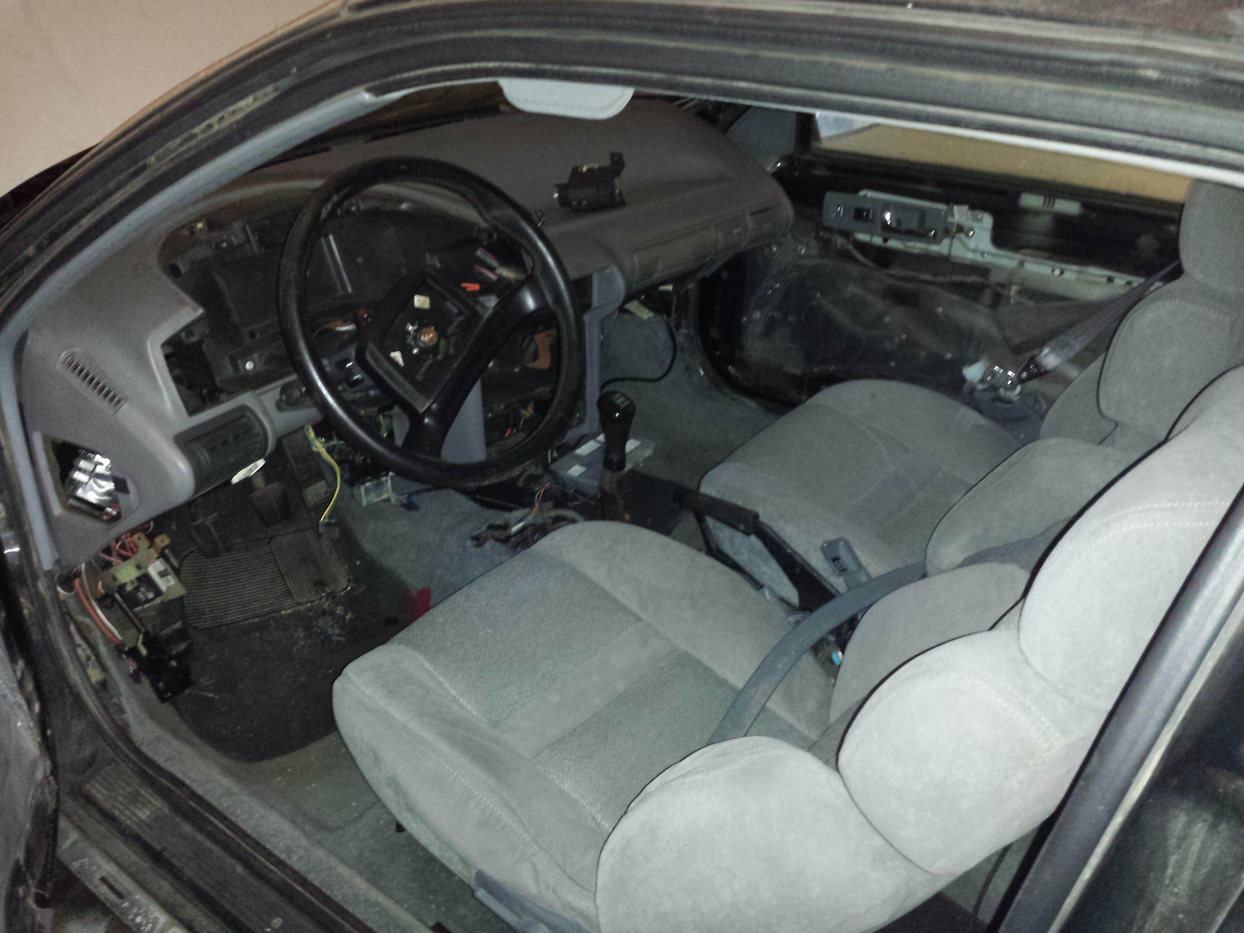

the car is basically moving from the current garage, to a dolly, then towed 30 miles and driven back up into its new garage. i would take out the DD battery, but i need that car to move. i'll just have to go around and see if i can get a used battery somewhere. Most all of my friends have trucks and i know those batterys won't fit in a quad. would if i still had my 2.2 base.
thanks everyone for their input.
the picture shows why i can't really drive the car far :P plus the tags are 7 years expired
