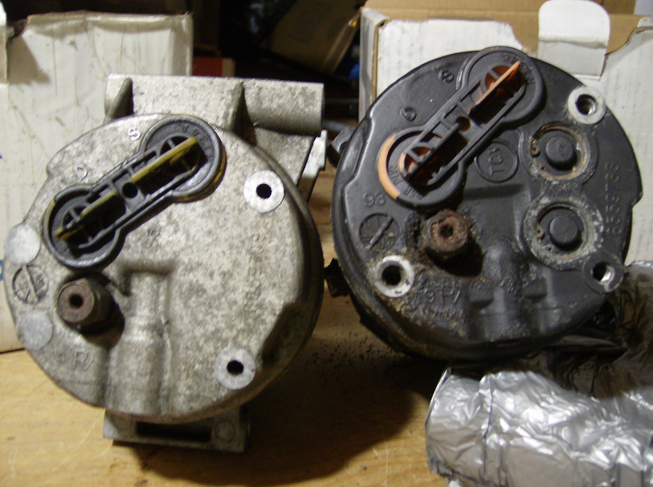

Here is my two cents. I have a 96 so your 95 may be different. Maybe somebody with a 95 can clarify.
On the old compressor I took off my 96, there are the ports for the refrigerant manifold and what I believe is a pressure relief valve.
There is no place to install that plug switch. I don't think you need that. On my system, I have a high pressure switch
on the high pressure side. This is the smaller line, behind the radiator near the top of the radiator. The wire has a connector
on it with 3 pins. If you have one of these, I don't think you need any other high pressure cut out switch.
If you have more ports than what I described and they are open, then you need that switch to at least plug the hole.
I think on my 94 Lumina van, I had to transfer that type of switch from the old compressor to the new one. But that was
years ago so my memory may not be clear. Two things I ran onto on my 94 was the first compressor they sent was not correct.
I forget why. The second one had different level of surfaces on the high and low side ports. My high/low manifold surfaces
where the same but not so with the compressor. I was able to compensate by using two sealing washers.

Postby ifixalot » Thu Jun 30, 2016 11:59 am
Here is a picture of my old 96 compressor on the left and my old 94 on the right which has the two extra plugged ports for a switch.
I hope this helps.

Thanks ifixalot for the great pics! You are a credit to the site. My new compressor has one plugged port for a switch. The instructions say" This compressor may be a standardized assembly applicable for service replacement of "no switch" or "switch type" compressors and may contain a plug in the switch cavity." So I guess this comp. was made to accommodate many different switch configurations on many different cars. So for my configuration, as it must be quite similar to your '96, the plugged port will likely be untouched and unused. I see the high pressure switch on the upper condenser line like you described and I suppose the low pressure cut out switch is on the low-side line somewhere, right? Yes , system was evacuated and flushed and I was holding out installing the new compressor and new drier until I got some clarification on the switch. The new comp. came shipped with oil. Do I assume they put in the correct amount or should I dump and measure? Also, what did you have to remove (if anything) to install the new compressor? I will probably do it this weekend..Happy 4th of July!! Sorry for all the questions. Thank you for all of your assistance and patience! Nice to know there are people out there willing to help.
