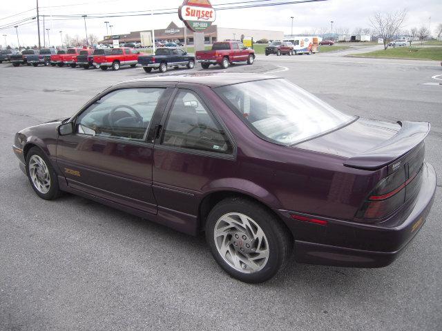

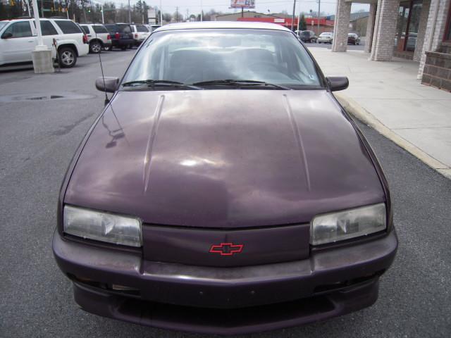

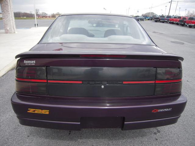

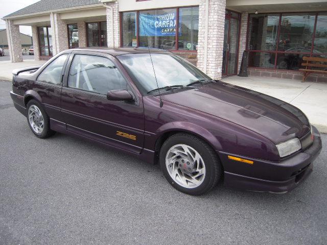

BODY
One of the cleanest northeast underbodys I've ever seen. Solid rockers, pretty much rust free!
Cracked upper filler, a bit of fading paint on front bumper and hood.
The rubber whether strip inside the drivers door IS COMPLETLY GONE.
All ground effects are intact, and very nice.
Drivers side door handle does not fit flush to the door.
Has 1 fog light out. ALL SIDE MARKERS WORK!
There is a pool of water in the trunk, where the donut is. ? I completly forgot to suck it out, the day was a bit hectic to say the least.
Thats pretty much it for the body. Overall it's SUPER CLEAN!

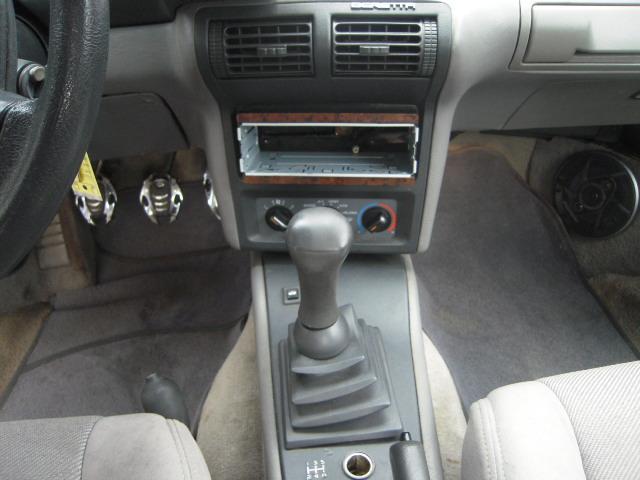

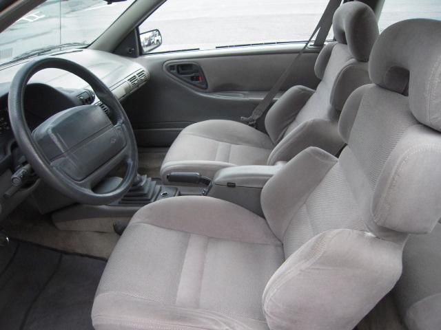

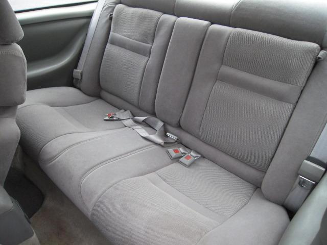

Interior
All the seats are good, one small rip in the drivers seat, barley any crushing.
Dash is a lil' bit bubbly, it's sort of even though, weird. The metal peice by the windsheild is loose. It's also crazy dusty, probably bout' an 8th inch of dust. LOL
The rubber around the E brake is gone.
Visors are bent, and the strap things are pinned to it.
The wiring for the map lights is gone, and the pass. side one is missing the plastic cover.
Has pioneer speakers up front, and sonys in back. I have no idea if they work, cause there is no damn deck in it!
Also has aftermarket pedals/covers, whatever.
But once again, quite clean.

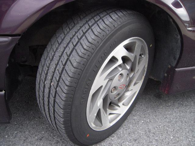

The rear shocks are rusted really bad, the shocks themselves are not rusted, nor the mount/mountng area. The drivers side was leaking a bit. The front end seems really good.
