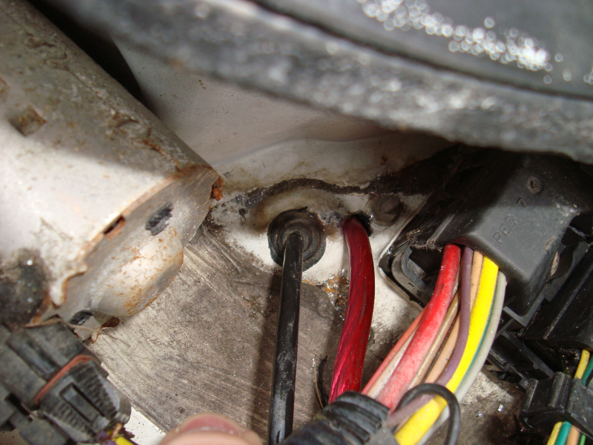

Thompson128
Posts: 130
Joined: Sun Apr 24, 2011 4:53 pm
Location: Groton, CT
Re: where
Postby Thompson128 » Mon May 02, 2011 7:32 pm
I don't know how well the picture shows, i drilled a hole right next to the hood release cable, absolutely invisible on the inside. Just be careful because there are wires in this area, check and double check where you will be drilling
