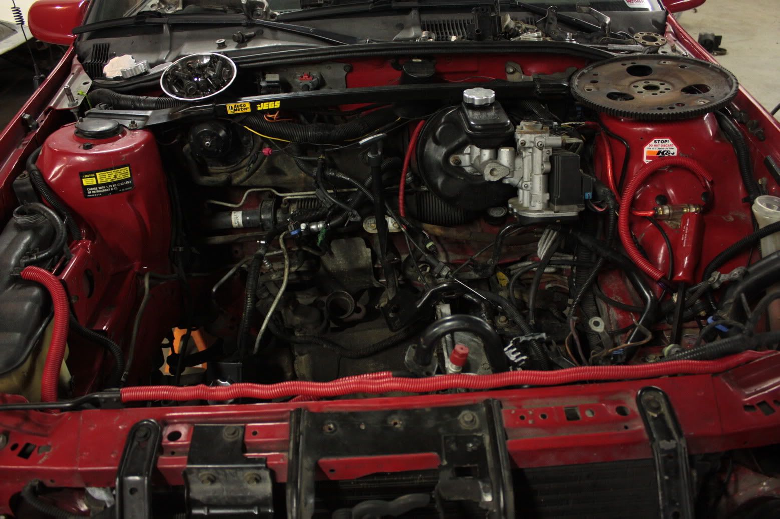

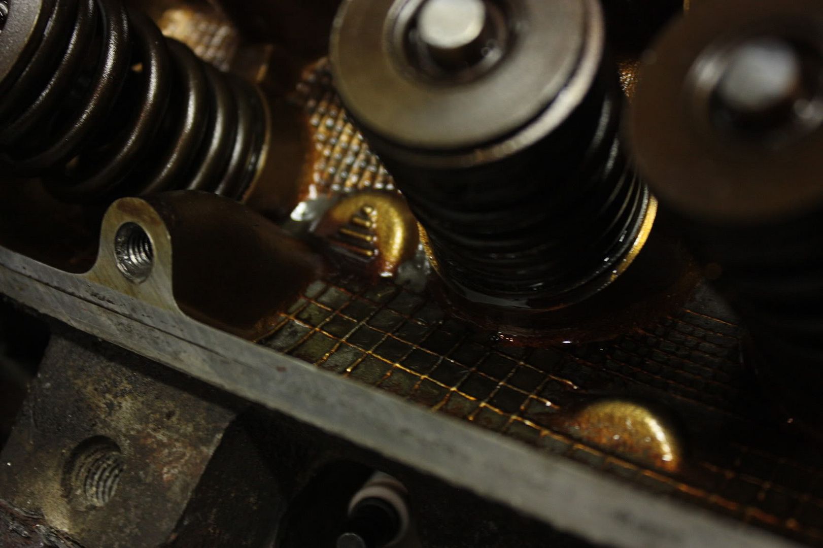

so as you may have seen, my gt has taken a poo. I was on my way home from work one day a while back and i noticed it sputtering a bit but thought nothing of it. Untill i glanced down at the oil pressure gauge. UT OH! 10psi at 2500 rpm's. Thats not cool (i thought in myself). so i called my buddie up at the shop and said "Mat, I think i've got a problem". the first thing he says to me is "no you don't, what happened?". then i told him about the oil pressure and he said "actually you may want to turn around and head this way, you've got a problem" so i went up to the shop (milzys) and we diagnosed that there were some type of metal shavings in my oil filter. I thought, ok, i'll change the oil to see if that fixes the problem. NOPE still horribad oil pressure and now it smells like pure burning oil, with a hint of main bearring going out (lower knocking sound but no rod knocking sound). well sheet. now what am i gona do. 3400 swap that bish!!!!! so i did/ am.
list of mods being done at the moment
Ported and polished upper and lower intakes
tce 65mm tb
ported exhaust manifolds
2.5 in downpipe
and i got progress pics. YAY!!!

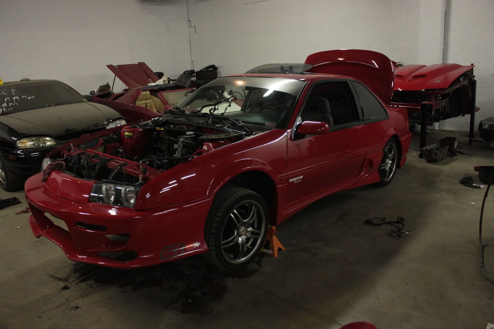

her sitting at the shop
Empty engine bay!
old valve train with metal shavings visible in base of head.

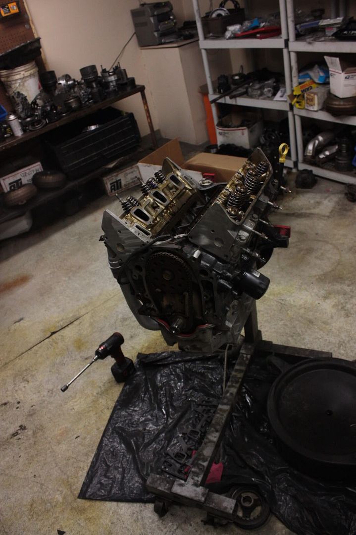

new motor on a stand

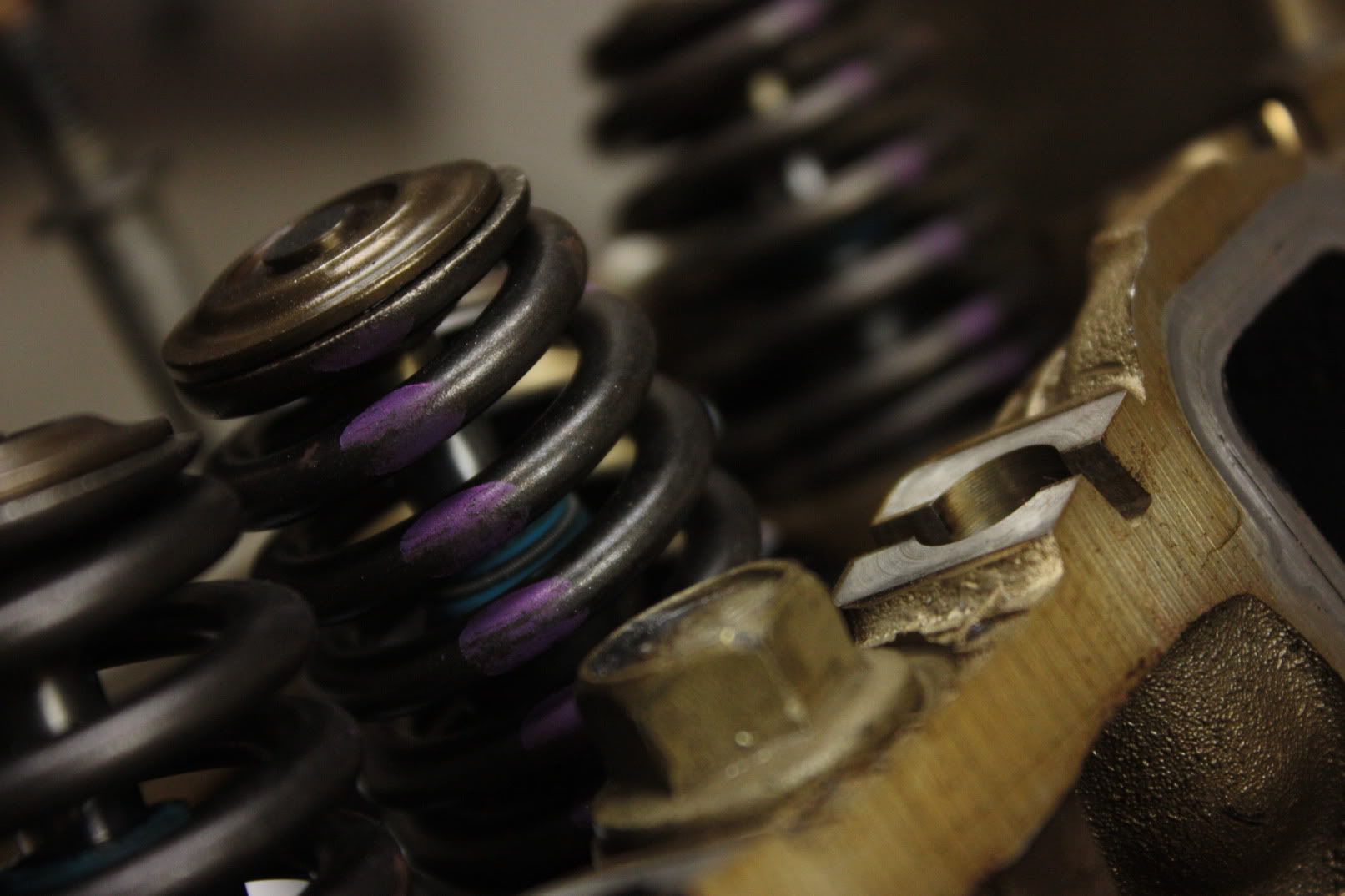

new LX9 springs and new valve seals
Empty engine bay!
- Posts: 10915
Re: 6r8ph1x: Real Reason To Be Called A Gt.
Not to burst a bubble or anything, but you do realize LX9 valve springs are simply 3500 springs... and they have a closed load of 77 @ 1.74 and open is 234 @ 1.299 where the stock 3400 springs are 75@1.70 and 230@1.260 so they are not that much of an upgrade. If I were you I would have gone with the Comp 986 springs if you were hoping for a higher closed and open pressure.
If you simply put those on to be new to the engine since it had 80k and weren't expecting any gains then that's perfectly fine.
