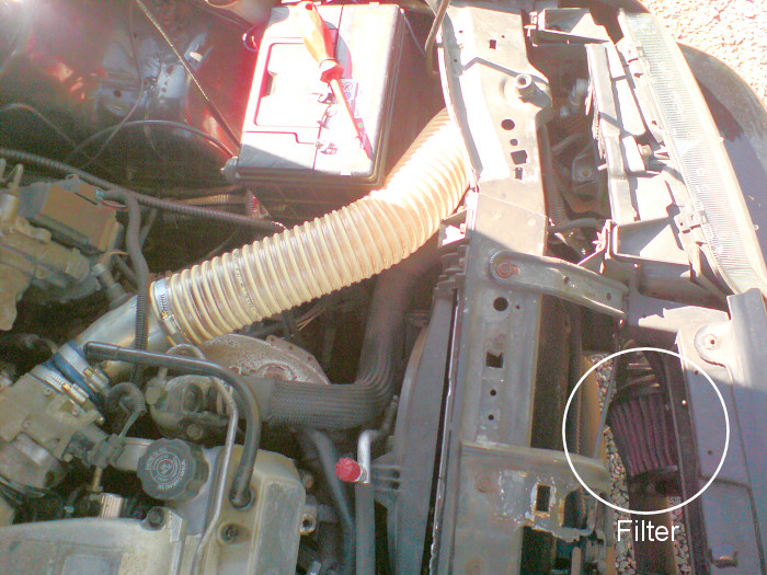

92 3.1 CAI
Postby n00b20 » Thu May 15, 2008 4:47 pm
this is the only one i have right now but i suppose i could go snap a few more if you would like.  :)

Postby Money pit Beretta » Thu May 15, 2008 8:54 pm
Still love that photo, I think weba was talking about the K&N mounted in place. That would be a hard shot to get. I also had a bigger K&N on the same intake as n00b20 has, it was a pain to get in and out. I would bet that mine was bigger than n00b20's(it had two filters in one). That's just FYI, not trying to say anything bad about your intake weba. I now have a 3100(had a 3.1), so now I may have to make my own. :)

Postby n00b20 » Fri May 16, 2008 12:49 am
heres the best i could get..

92 3.1 CAI
Postby weba » Fri May 16, 2008 6:55 am
That filter is smaller than the one i have, that seems to be 'longer' so it fits there, while mine is Wider :\

92 3.1 CAI
Postby n00b20 » Fri May 16, 2008 3:07 pm
yea that might be it, the one that came with the tranzgenic barely fit in there and this one is alot bigger than it looked at the shop. but i also had to cut a little bit off a couple of the pipes to shorten the length a little.

92 3.1 CAI
Postby Money pit Beretta » Fri May 16, 2008 10:57 pm
Man, I should have cut mine. I had to bend the horn back for the pipe so the filter would fit in that small space. Hey weba, that pipe should be covered to block the heat(it may dry out and crack). I used some wide reflective(tin foil looking) tape on my homemade intake(before I got the Tranzgenic)it was for heater ducts in the house(used nylon ties to hold it on). My Physics friend told me that you can reflect heat like light. That's why most intakes are shiny.
