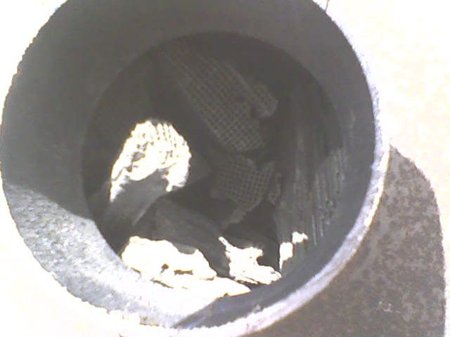

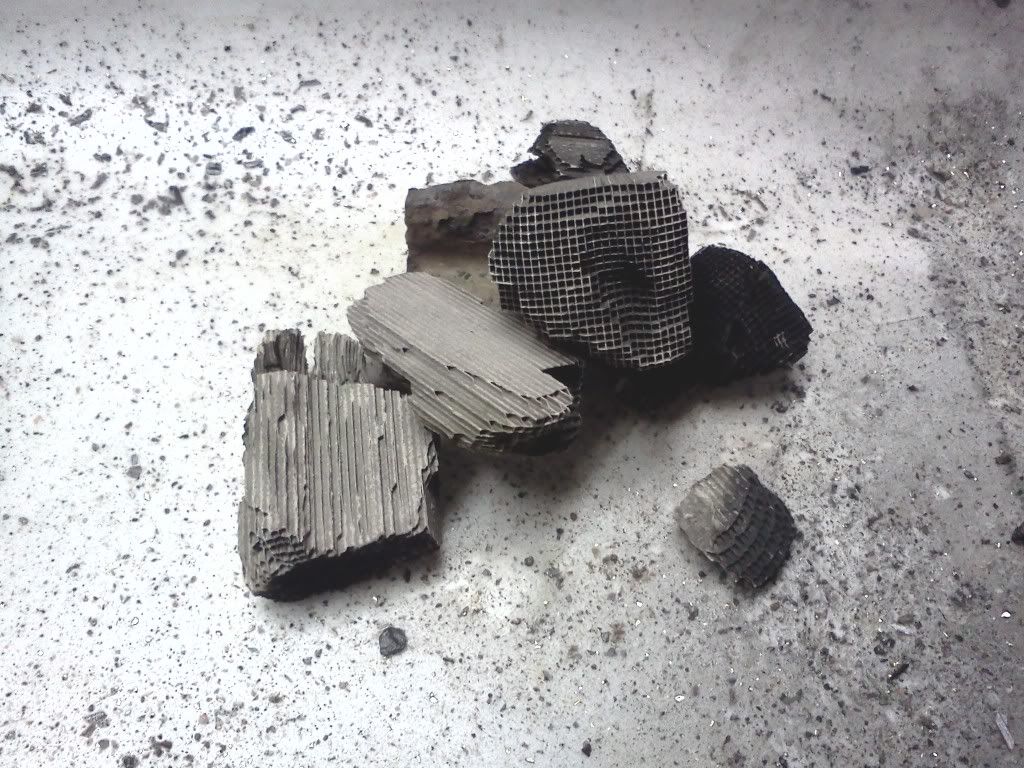

Well I have a diagnosis, I think these pics speak for themselves
It was plugged solid right at the outlet, I couldn't dislodge it with my fingers. So I got my trusty ol jackhandle and beat the crap out of it, start and rev, beat more crap out, start and rev again.... I got it all broke up and blown out, but the honeycomb must be in 2 halves inside the cat, front and rear if you will. I can see that there is still half of it in there but it is a nice perfectly flat surface that looks to be a complete full half. I left it like that for now at least, so I still have some cat efficiency there. I have to get a new piece of pipe for behind it so I may knock the rest out then.
Works a hundred times better now! Sound has maybe increased a bit, but I haven't driven it enough yet to notice much difference. Wife says it louder though. I still get an occasional miss or stumble at high rpm, with CEL coming on (which has never been on since I've had the car), but I'm hoping an ECM reset and new plugs will fix that. I imagine they got pretty fouled in the last couple days I've driven it, especially today when it plugged up completely.
So you guys were right, I've never had a clogged cat and never thought it would make it work like that! I expected power loss etc, but not all the high idle/hard starting, etc. Now I know! Thanks for your help! I'll let ya know how it works tomorrow after I take it for a good drive and get some parts

Don't leave that cat in there with crap still in it. Remove it. You're going to wind up with the same issue again sooner or later otherwise. Trust me. That's why you still have issue sometimes now.

ya I think I'm probably gonna punch the rest out when I take it back apart to put the new piece of pipe on it. It's in there correctly like it should be, but I figure it'll eventually get broken up as well. Gonna go get some plugs later today and do it all after that. My CEL comes and goes as of now, it's usually off when I first start it but then comes on after a few minutes of driving. Car is still working good however and pulls harder than I ever remember, for good reason I guess

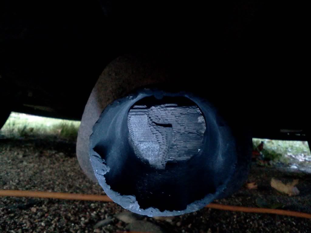

Well I picked up some plugs, got the Autolite Iridiums like you suggested, ~9 bucks a piece. They only had 2 boots in stock so never got them yet. Came home and let er cool off before changing the plugs, and I also pulled the exhaust back apart and punched the rest of the honeycomb out of the cat. It had slid back in the cat about 4 inches so I figured I better get it out of there. Had a hell of a time breaking up one piece that was too big to come out, but I got it eventually. Car is working A1 now, no miss, starts right up and idles fine. The CEL is still coming on after ~ 5 mins of driving every time I drive it. Not sure what's causing that.
It got noticeably louder after punching the rest of the cat out, it's got a 'tinny, hollow' rasp to it now, along with that braaaapp noise when shifting. Sounds kinda like a beat up old civic atm :/ I'm thinking about either putting a cherry bomb glasspack in place of the cat, or picking up an $80 universal magnaflow cat at canadian tire. I like the louder sound but want to deepen the tinny sound down a bit, would a glasspack in place of the cat sound decent? I don't care about having a cat on it, just would like a nice deep tone to it without sounding too japanese

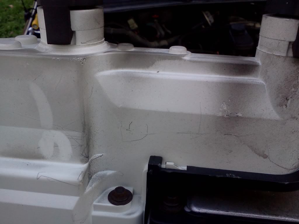

Noticed these tiny lines that looked like cracks on the coil housing, but you can see where I rubbed it off with my finger. Are these indicative of pending cracks, or just random dirt?
