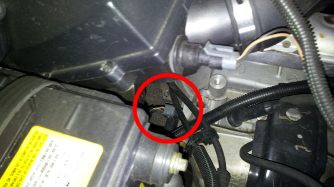

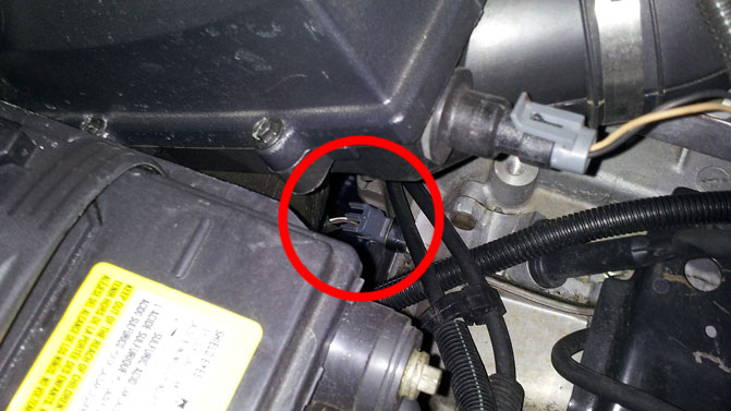

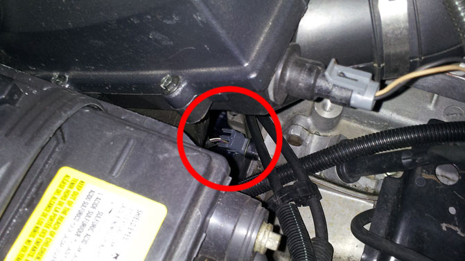

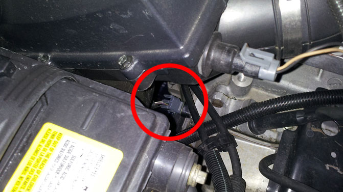

thanks eric!
this one?
I managed to tilt it up, but the plug is still stucked in the trans
how can I unplug it without to break it?
...cruising
92 GT 3.1 MPFI auto 57K white
Re: engine stuttering
There is a clip on it.
I forget but just release the little lever thingy and it will pull off.
berry
Posts: 176
Joined: Sun Sep 02, 2012 11:29 am
Post by berry »
yeah one clip I already released. is there a second one?
...cruising
May be two sided. I forget, sorry.
Or just cut the damn thing, Pain in the ass as it is!!
