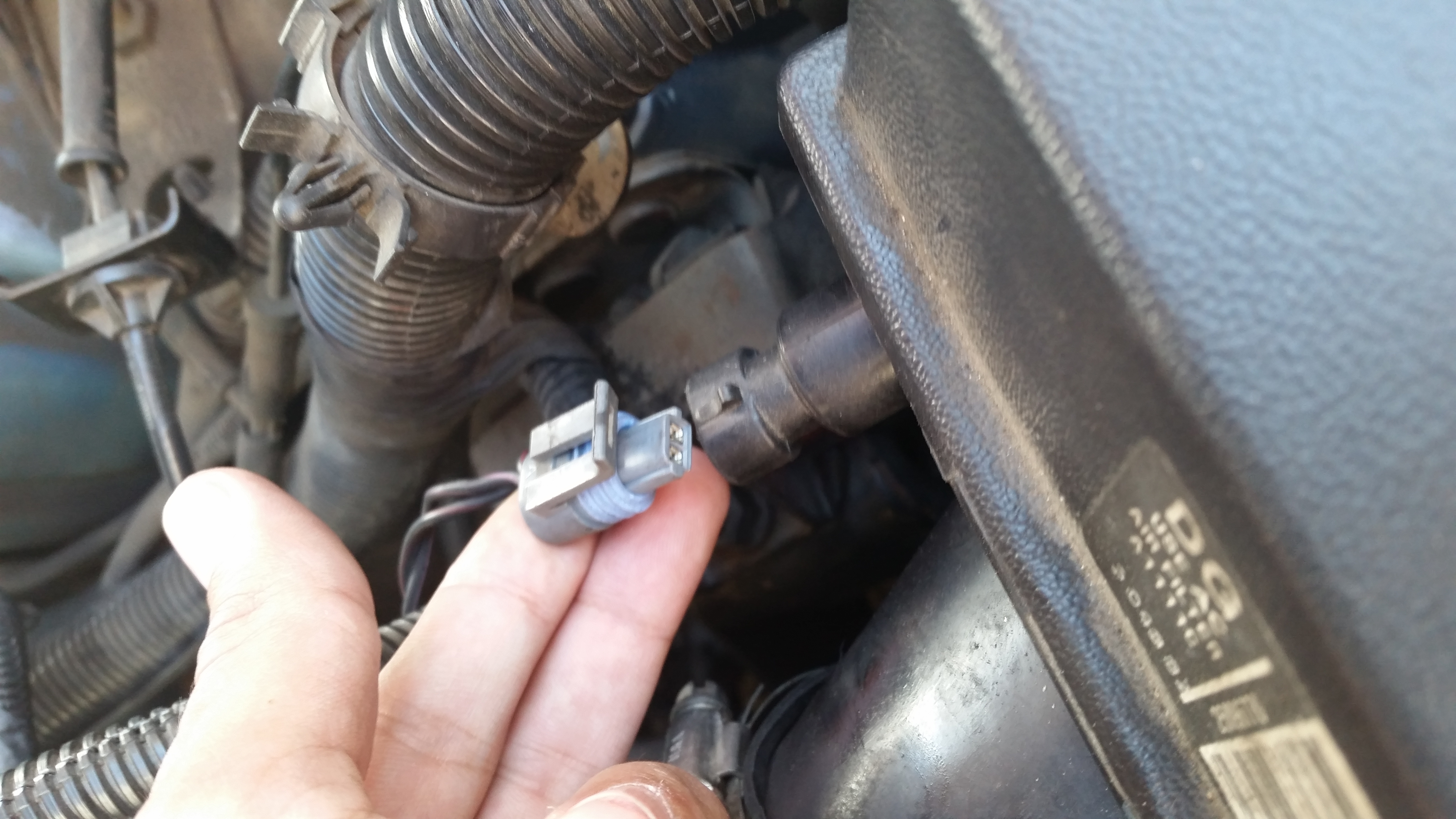

The MAF is located between the air filter housing and the throttle body.
http://www.ebay.com/itm/like/3112041957 ... rmvSB=true

External to the trans, unplug the TCC Solenoid. Test drive for a normal commute & report results.

If this is an idle in park stalling condition then that would exclude the TCC all together... but if this only happens after driving at a steady speed then coming to a stop I would have to agree that the TCC is not unlocking as it should. Another way to test that if you can not find/unplug the TCC (not the sensor pictured above, that is the Intake Air Temp sensor) try just putting the car into neutral when coming to a stop and see if it stays running that way. It will probably still stall as soon as you try to put it back into drive if the solenoid didn't release.
