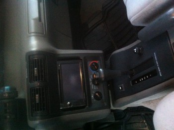

Postby 96/z26 » Tue Jul 16, 2013 8:13 am
Just need to have a fascia custom made to clean up the bezel
