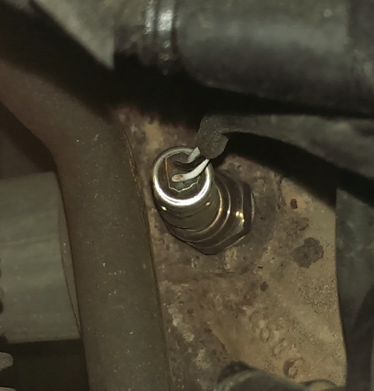

Car has been running perfect no issues at all!!! Then I decide to finally install the custom t-mount (thanks summitbalt08). I drilled the bottom and all went in no problem.
After a day or two my SES came on, P0134.
Sensor looks bent, works when it wants to. Any short sensors out there? BTW, im running Grand Am 3400 exhaust manifolds.
I took a look and found this....
1of 896 Quad4 Z26's....now 3500 5spd swapped!

What did it hit? Was that a solid trans mount that you put in?

Aside from swapping manifold, or going down stream heated, you're fresh outta luck.

Its hitting the steering arms.
Ill make time and take it to the muffler shop and weld in a new bung where it won't interfere with nothing. (Only thing I can think of)

Yeah the Beretta stock location is on the crossover inlet so its not directly on top of the manifold and with the 1" movement necessary for a 5-speed alignment you loose valuable space back there. I never had a problem with my 3400 manifolds and the auto.

Would it matter if I have the muffler shop weld in a new bung on the downpipe right where it connects to the manifold?
Would my O2 readings change?
Has thanked: 18 times
Been thanked: 11 times
Re: Oxygen sensor rubbing after custom t-mount install
Postby 1988GTU » Tue Nov 19, 2013 6:26 pm
If there are no leaks it should be just grand.

Just so you are aware there is a shorter O2 sensor that would probably work, in fact I have one on my GTP, its made by denso for C5 vettes, downstream, you will likely have to re-pin it but that's not overly difficult. It's .75" shorter IIRC.
