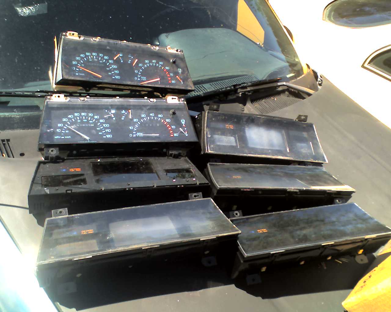

... And the winner of the worst photo is...
-and guess what? Neither one is a 194! I am thinking those were in the '90 models, so it is looking like they changed them every year...
I will be pulling the cluster out of my '90 Yellow Indy here shortly to start testing these other clusters, mainly for Lespaul59. I will try to snap a pic of the bulbs in that one, I really could have sworn they were the T10 (194, 168, etc) style bulbs usually used in GM instruments, but now I am wondering, as that would mean that ALL of these clusters I have as spares are '89 and older:
Either way, just removing the dead bulb and retrofitting the socket with an LED would be relatively easy. Or, just solder them directly to the wires feeding the bulbs' circuit-board, and just use the board to support and locate the LEDs, simple.
