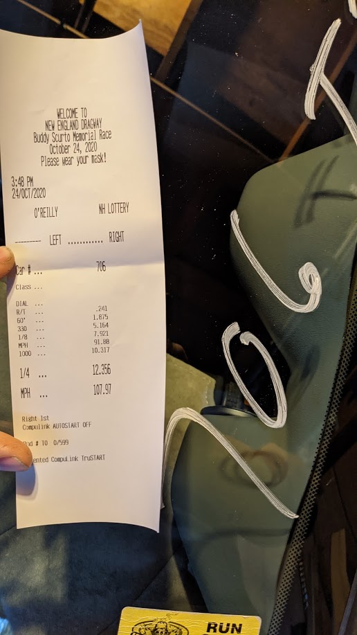

Postby woody90gtz » Sat Jul 14, 2018 11:38 pm
Not the timeslip I was looking for, but the Bfest was right in the middle of a heat wave...with the DA at 2500ft. I'm planning on getting back to a 1/4 later this year with some better horsepower weather. Shooting for 13.5@ 100+. This slip is through full exhaust with cat and muffler. I usually gain a couple tenths and a couple MPH with my cutout open but ran into 8* of spark retard (of presumably false knock) so the time was actually slower. Same MPH but my 60' sucked too. My previous best was a 14.4@92 and 14.5@94 without the heads and cam...but that was also with 4th gear issues.
'04 3400, stock bottom end, WOT street/strip cam, WOT stg2 heads, TCE 65mm tb, S&S headers, full 2.5" exhaust, autocross tires, DIY OBD1 tune
https://www.youtube.com/watch?v=Ueb23fwhQos
