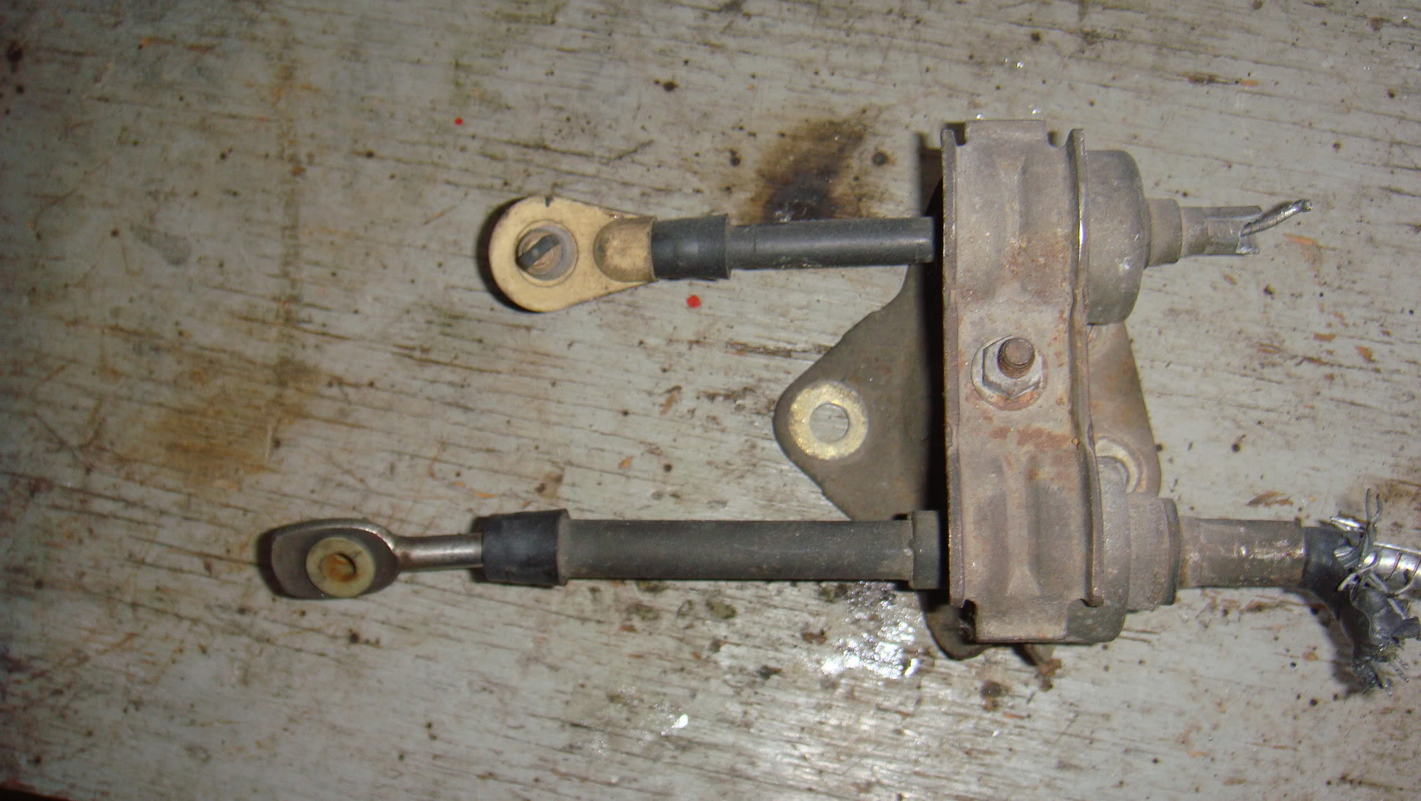

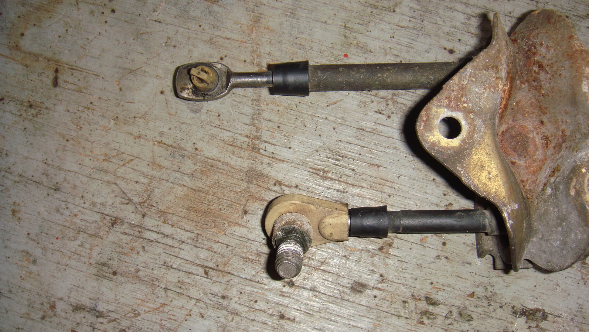

Now we will get into the more confusing part. Gm used 3 different style cable ends. There is no logic to this because I have seen cables in pretty much every combination of ends...
1. Came on early berettas, 87-90, maybe even 91. This is the strongest end available, its all 1 piece steel, minus the plastic bushing/clip.
2. Came on all years of berettas. *Usually* it is only on the shifter side, however, my 88 cables have it on both ends. This design is alright, I have not had one fail on me.
3. Came on later berettas. It uses a bigger pin, so its not compatible with end 1 and 2. These suck. The bushing tears easily, so the shifter becomes very sloppy. They are also fully plastic and can crack once the bushing takes a dump.
1&2 both fit on the same pin. You can see in the pic that the pin is bigger on the 3 end.
I am unsure if the 3 pin is bigger on the trans side or not, but generally the pin stays with the cable.
