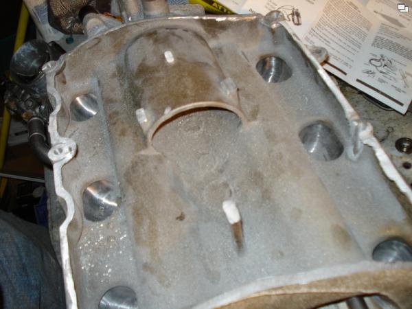

Eric, that intake isn't being used next year. Won't fit under the hood with the direct port spacers installed.
Not sure what I will do with the bay yet, still cleaning up some of the seams and then resealing it, I have time to think on it.

3X00-Modified wrote:Eric, that intake isn't being used next year. Won't fit under the hood with the direct port spacers installed.
I forgot your plenum spacers were so thick, i think mine are only 1/2"
You should have yours shaved down since you can still drill/tap/use a 1/8" NPT or 1/4" NPT with 9/16" thick aluminum spacers + the 3500 plenum

I'm not a huge fan of the 3500 plenum anyways, and there are mixed reviews about it flow wise and such... The nozzles are 1/16th NPT and they are already tapped in the spacer I thought about getting them shaved down some but I'm not sure. I also have to use gaskets so that adds thickness. I know yours are o-ringed and mine don't have cuts for that. So unless your feeling bored and want to o-ring and shave these spacers I'll probably stick with the 3100 large port upper intake.

3X00-Modified wrote:I'm not a huge fan of the 3500 plenum anyways, and there are mixed reviews about it flow wise and such... The nozzles are 1/16th NPT and they are already tapped in the spacer I thought about getting them shaved down some but I'm not sure. I also have to use gaskets so that adds thickness. I know yours are o-ringed and mine don't have cuts for that. So unless your feeling bored and want to o-ring and shave these spacers I'll probably stick with the 3100 large port upper intake.
Hah i got bored of machining the 2nd day i was here LOL
Yeah for boost in a turbo app obviously the 3400 UIM would be beneficial to add TQ because to the runners (VS the 3500 wide open space inside), but may hurt topend, for my S/C i feel it beneficial to get rid of as much TQ as possible everywhere in the engine..
For your case i'm not sure though, it may add 10-15hp, but in your case just add more NAAAZZZZZ

3500 isn't wide open, it's a tunnel from the inlet till about half way into the middle of the box, there are questions about poor flow to cylinders 5/6 because of the 180 degree direction change the air has to make.

Did the guy cutting apart that UIM - weld it back together?
Any better flow?

No he was making a SC mounting plate on the top of it.
