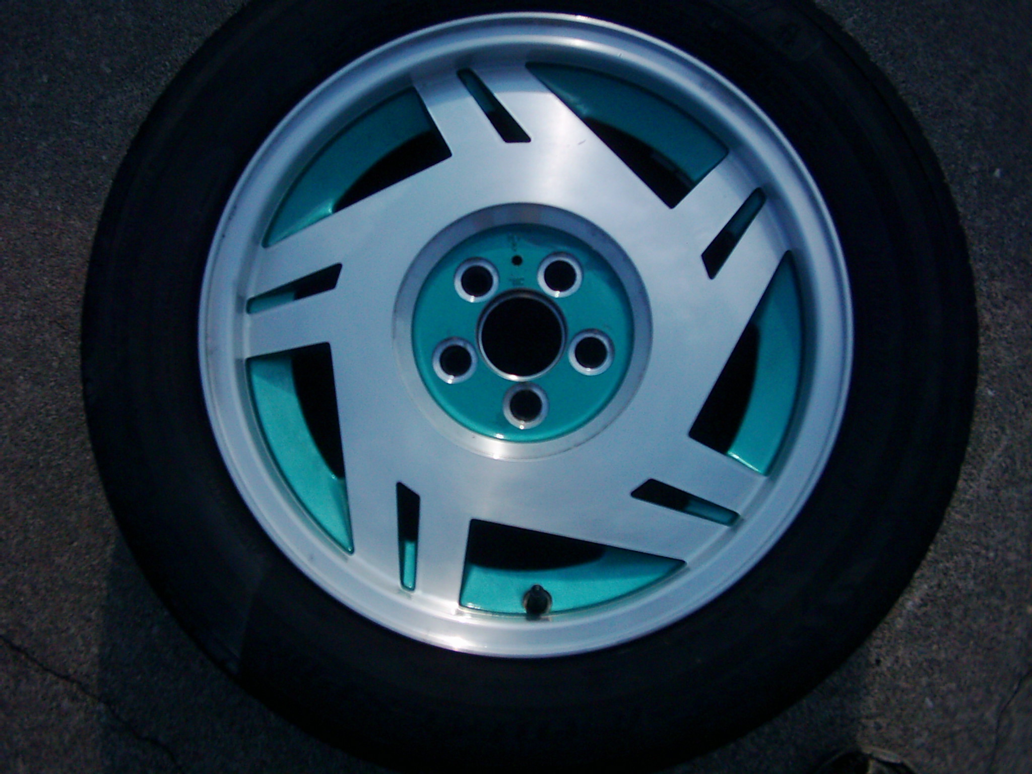

Hello everyone! I am ecstatic at how my indy wheels turned out. I can't bite my tongue any longer. Actually, its just prioritizing to post instead of continuing work at 11pm.

IF YOU ARE THINKING OF PAINTING CLEAR OVER BARE ALUMINUM, THIS POST IS FOR YOU.

Next, and after the fizzing, its rinsed with water in accordance with directions. Then ALODINE is used. I used Alodine 1001. Rinse with water. The wheels are now ready for clear after drying. Because I painted indy wheels which has paint in some areas, I then started with acid-etch primer, the green stuff. Duplicolor wants you to wait 30min. Others like TEMPO want 24h... I haven't found a best spray etch prime can yet.

I layed tape over the clear parts of the wheel carefully, and not too hard, to paint the green inserts before the clear. remove tape and cleared the entire thing. It worked and I'm happy.
Corrosion was remediated by gray/maroon scotch brite before Dawn-soap washing. Different color means different grade. this way, I helped maintain the machine swirl. We got most corrosion off, and I'm happy with it. Its as good as new to me, but to the discerner, they could want more corrosion out, and I preferred to keep the original machine swirl, and I did which would have been lost in sand blasting.

Its amazing how I even function. I do somehow manage though. oh, and I'll have to update this later with a finished picture... that I'll be taking in two min because its still off the car and I can get a good sunlight pic.

The digital cam apparently didn't wake up this morning. If I can get a sharper pic, I'll post it.
