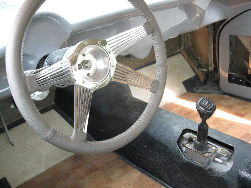

Nice, it would be pretty cool. Something to think about is the torque tube is giant. Not sure if you would adapt that to work or not. Pretty sure its bigger than a t56 tho, and its the whole floor. I Built a nomad (well some of it) way back when i worked at a street rod shop, it had full c5 drivetrain, almost had no room for a seat. Like the beretta, it was a lot more narrow. Ill see if i can dig up some pics tonight

Pics dont really do it justice for how big it is, compare it to the t56 belhousing pic i posted earlier up aginst the beretta. Something to keep in mind anyways.
