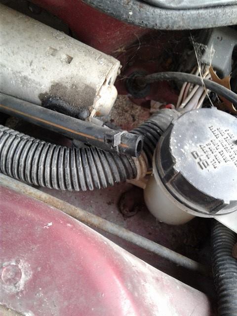

Here are some pictures. Basically I have the shifter hooked up, now I need to hook the clutch pedal and that stupid finger thing that I can't get back on.

How do I secure the shifter cables? Can't seem to get the thing in neutral.

bmroyer wrote:How do I secure the shifter cables? Can't seem to get the thing in neutral.
Try lifting the front wheels off the ground with a jack so they can rotate freely, then you should be able to take it out of gear without the clutch being pressed.
That slave cylinder needs to be compressed (Pushed fully in) to get that clutch fork finger thing back on the clutch fork, it is keyed and only goes on 1 way. Might be easier to remove the slave cylinder then install that on the end of the clutch fork, then put the slave back.
Just to note, If there is any air at all in the slave/master/lines it will not work properly at all.
When I had mine, I had to bench/gravity bleed it for a while before I finally got all the air out, and I carefully strung it back into the car in 1 piece.

Looks like you're missing the bracket that the shift cables attach to.
