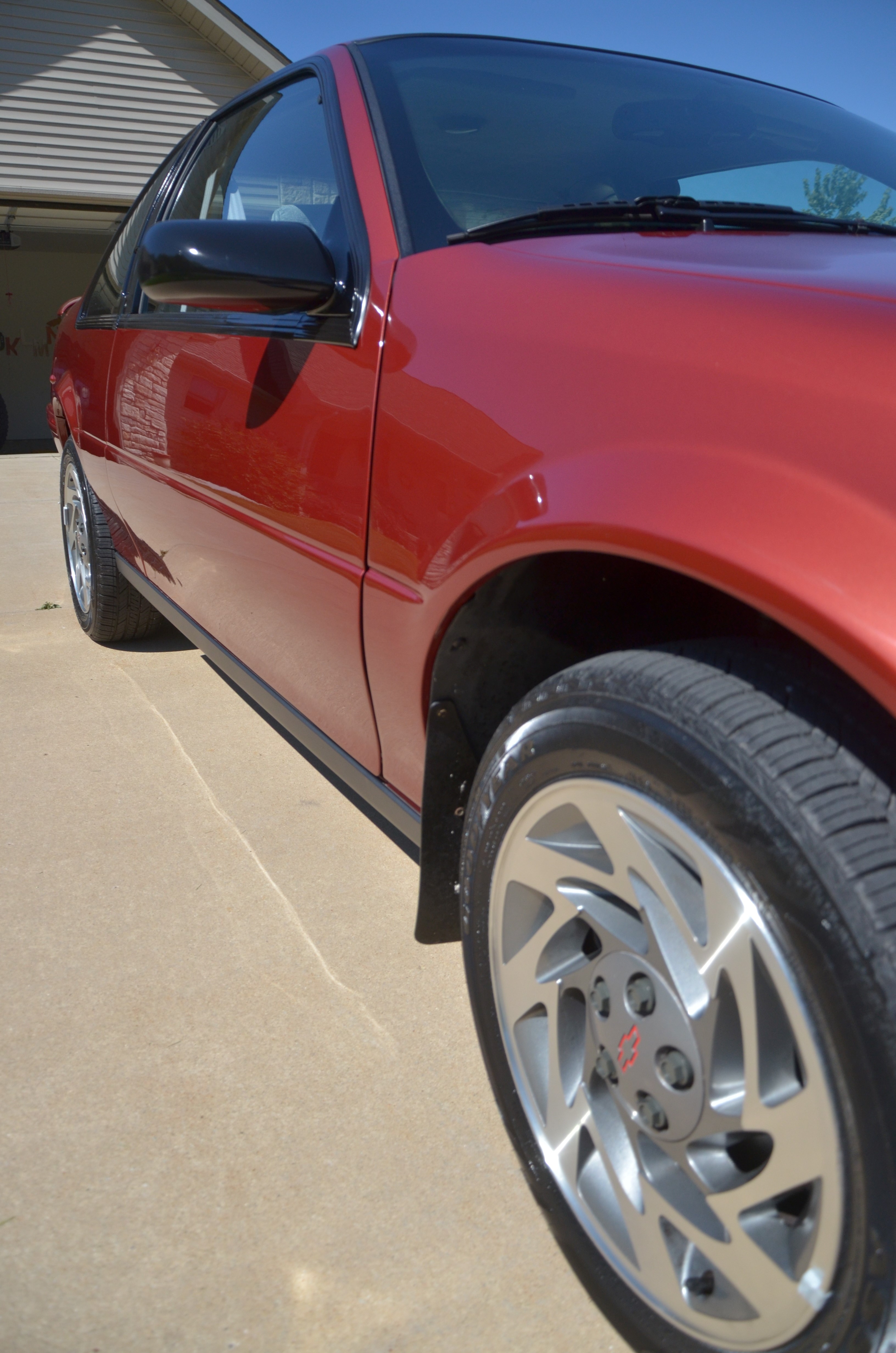

Back From Paint (Nov 2016)
The paint shop did an amazing job. Only one decision I slightly regret. I had them patch the passenger side fender antenna hole. I replaced it with a hidden antenna under the dash, the reception is ok, I just miss the old school look of the whip antenna.
Getting the car back together started with plumbing the fuel system, wiring and finishing out the engine bay. Dash install and drop in the rebuilt original 3100. I had a little issue getting it to fire, that was all my fault, but the factory service manual and Scan9495 software got me out of a jam. She ran sweet at that point and all I had left I thought to myself is" suspension, brakes, steering, glass, interior. This will take no time"
I used the wheels off the Z26 because they are in great shape and I couldn't bring myself to put plastic hubcaps on a car I just dropped so much cash on paint.
I bought all new AC Delco parts when I could, fell in love with Rock Auto for a while. Tracked down NOS weatherstrip. Painted the trim around the side windows with SEM Trim Black which looks great and I just hope stands up. It was a lot of spending money and bolting stuff together at this point.
Interior I took to a place for the whole treatment. Recovered all the seats, kick panels, visors, headliner. Had them add seat heater pads while the front seats were apart. The results by them are fantastic, match the factory look really well. New carpet I did myself from stockinteriors.com. Turned out good. A bit of a pain to fit though.
The Finished Product
And 1 happy wife on Mother's Day when I presented it to her. Hopefully the daughter will drive it in 11 years when she turns 16.
