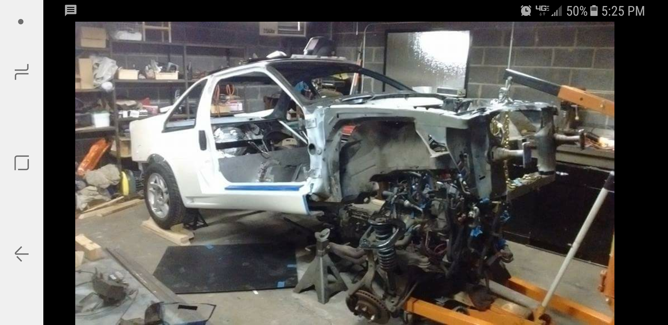

had to take a break from reality for a few hours. trying to finish up a few projects at once, had to make some time for the Beretta!
It Looks like this is where the engine is going to sit for sure now. Back end might need to be tilted up a bit but it will work. Ill know more when the trans has a spot in the floor. Not sure im ready to cut that out yet.. might get a little flimsy.. Ill be cutting a little more up in the cowl area to help with install/removal of the engine. I will have working wipers using the factory motor!
headers will be interesting..
just had to do it.
had to toss it together with zip ties to see where my shifter was going to land. Its VERY nice seeing my car look like a car.. even if it has no firewall.. or engine.. haha.
really thinking Ill be moving the speaker location in the dash.. I have a feeling thats right where the cage will go. Im 90% sure its getting a full cage. Gotta have a stereo!!
confirmed. The shifter location will work just fine with the engine moved back. Seat location seems perfect other than a bit low.. and im unsure about the pedals. These seats are TERRIBLE to get in and out of.. but once your in, you dont want out! they are pretty awesome.
I think the front subframe is getting moved up 1/4" and the rear posslibly lower ~half an inch. Not 100% sure yet but I think im going to just have to split the difference so the engine fits under the hood at the right angle. Getting closer!
