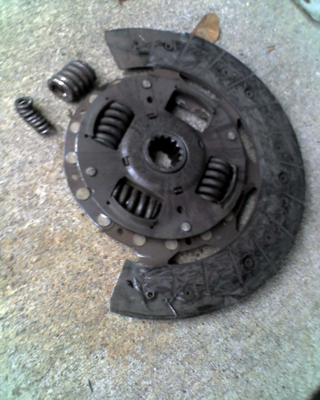

Well, Project WTF lives up to its name again! Sort of. I initially named it that because when I got the car the previous owner sold me the car without and installed engine/trans and claimed to include all of the original stuff with the car -- which I later discovered was a lie. I had to source much of the drivetrain separately because he basically sold me a 1993 GTZ with mostly 1990 engine stuff. Anyway, that's long since resolved, but the car had me going WTF last night.
About a week ago I took the car out to run some errands and while doing some runs near the rev limit (~7550) I went to shift from 1-2 and it wouldn't shift. I pulled into a lot and checked it out thinking maybe I'd hurt the clutch. There really wasn't any noise so I didn't think it was internal to the trans. I could shift just fine with the engine off but I had no clutch pedal at all. Figuring it was the master/slave cylinder I was able to put the car in gear, start it in 1st and then rev-match and get it through the gears well enough to get me home.
Last night I pulled the trans and discovered that the clutch decided to eject a portion of friction material. Thankfully the pressure plate caught most of the material so it didn't do any damage to the transmission itself.
The clutch itself was a very basic, Chinese made Valeo/Perfection unit from Advance Auto. I bought it in 2013 when I first put the car together. I was spending so much money at the time just to get the car on the road that I opted to go with a lower quality unit, knowing I wasn't going to be attempting to put down any real HP numbers... Apparently that clutch wasn't up to the task of spinning that fast. When the friction material came off, the pressure plate fingers sunk in on one side which then caused the release bearing to sit crooked and create a leak in the slave cylinder. So... looks like I'm in the market for a better clutch. I'll also be putting in a new clutch master and slave cylinders as well as a stainless braided hydraulic line to get rid of the oem plastic one.

Posts: 1811
Re: 1993 Quad4 GTZ: Project WTF
Your old clutch-disc looks a lot like the one that came out of my GTU six years ago. Not really that clutch's fault either -with conservatively guestimating over twice the HP and about twice the torque that it was designed for (maybe about 320 vs 160 ft-lbs), it nonetheless served me well for years before succumbing to the abuse of towing another car for a move across country...
BOOM!
BOOM!
After this, I switched to a 12-puck ceramic disc and higher-performance (Stage-3) pressure-plate. I had to change-out the disc again a little while later when I upgraded to the six-speed F40, but these performance clutches are the best way to go. I like the look of yours a lot, I bet it doesn't have the same grabbiness of my puck-style clutch either. :good:

DanteGTZ
Posts: 768
Post by DanteGTZ »
GT_Indy wrote:I feel like I'm the only one here who never broke a clutch on a Beretta. lol
I did have a throw out bearing fail once on my 88 GT causing it to spin and pop off the fork. That was scary because those clutch forks can't be found unless you get lucky and buy another 282 trans. lol.
I got lucky that day, engine stalled when it spun and I never restarted it because I immediately knew the clutch didn't feel right.
This was my first failure (other than just worn out). I blame it on the cheap, Chinese clutch and the 7500+ RPM shifts. ;)
