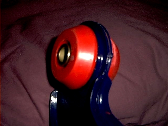

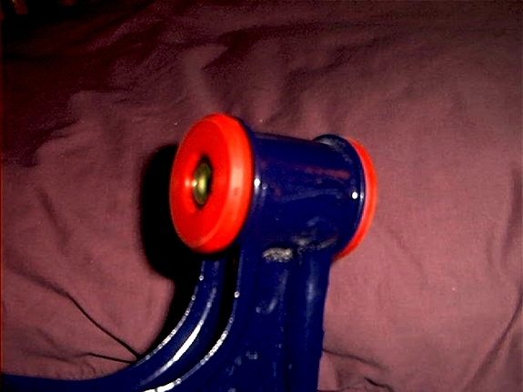

I ordered a set for a 1998 Chevy Cavalier from Summit Racing. Part # PTP-7-234 for $30.39
The horizontal ones are a direct fit. The Vertical back ones will fit but you need to machine or grind the A-arm socket (or metal rim) down to 5/8" thick. I milled 175 thousands off each side or about 3/16" They fit great. I will be checking on the height of the back bushing compared to stock it may be just a little shorter (flat washer on top and bottom maybe). I will also be comparing the back pivot bushing on the rear axle to the cavaliers to see if energy suspension has those also.
I will post some pics later this week

Postby Saphire Mule » Tue Jan 02, 2007 12:45 am
Just to let everyone know there is 300 thousands difference in height on the back bushing,
and to use 2 grade 8 washers one on top and one on the bottom to make up this difference. Will try to post these pics.

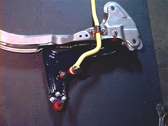

Postby 3X00-Modified » Thu Apr 28, 2011 11:03 am
94+ control arms with cavalier bushings installed.
I will be doing this with mine sometime soon... I am already running the fronts, I just need to get another set of control arms and I can do the full setup since what I have is somewhat rough.
I would actually like to find a set of rails in decent condition too.

Postby ErichZ26 » Fri Apr 29, 2011 8:00 pm
who's is that? That looks nice. Do those J body bushings work nice?

Postby 3X00-Modified » Sat Apr 30, 2011 8:02 pm
I have the fronts only now... not sure what happened to this owner of this but when I find a nicer set of control arms im gonna do the whole setup like above so ill let you know then.

Postby ShaneLT(ShaneZ26) » Sun May 01, 2011 7:33 am
This may be a dumb question to some but its an honest one.
What is the name of the part that runs side to side in this pic? The shiny silver piece? And is it from a Beretta? If so where can we get new ones?

Postby Wanako » Sun May 01, 2011 10:37 pm
Shanez26 wrote:Anyone?
the two silver ones? that would be the subframe. Where to get them new? don't know, but you can find them in most yards and are quite sturdy as long as they haven't been eaten by salt.
