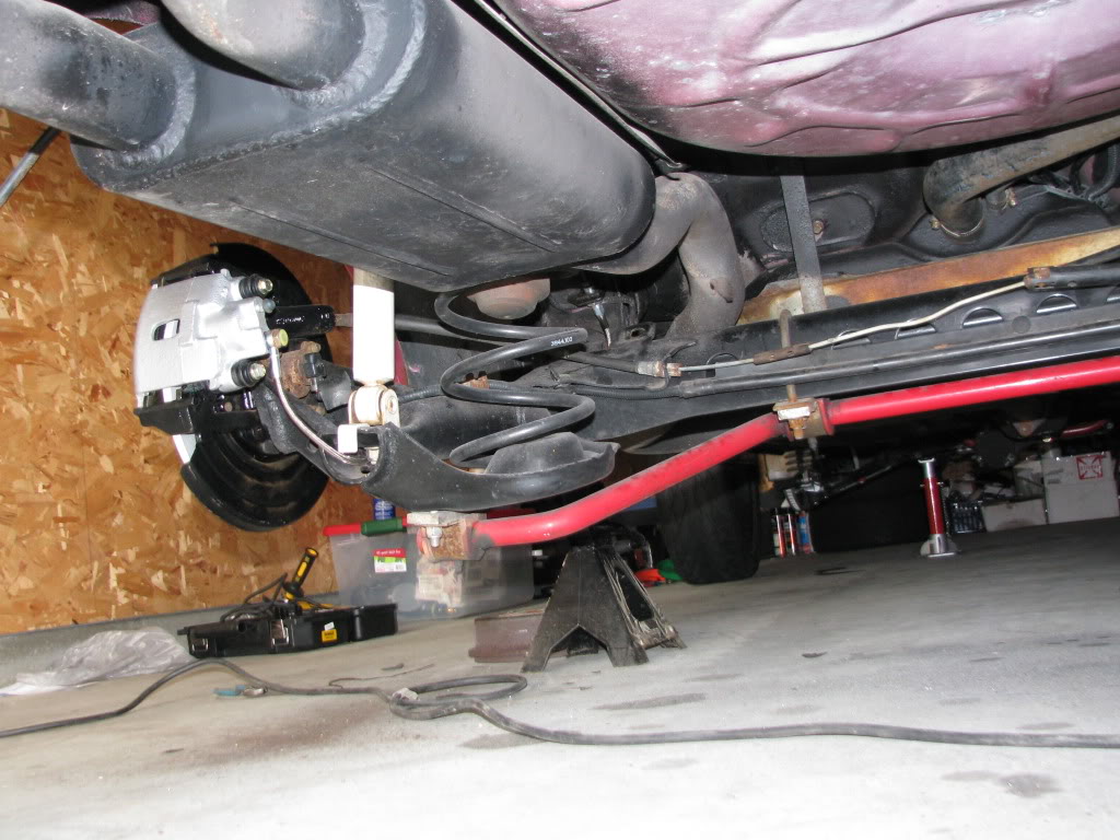

Brakes are installed... HOLY simple bolt on when you get the brackets done.
Lines and Adapters used
63011626ERL X2 3an to 7/16" Banjo 26" Hose
977522ERL x2 7/16 x24 Single Banjo Bolt (For Line to Caliper, I didn't have good ones)
989534ERL x2 Brake Adapter 3an to 10mm x 1.0 Female NOT Inverted Flare.
Double check all of your factory lines because you may not have the 10mm x 1.0 bubble flare like mine, my lines were all stock, but I do not know if they used that same line for all years. I know it applies to at least 94-96 since those all have the same rear lines.

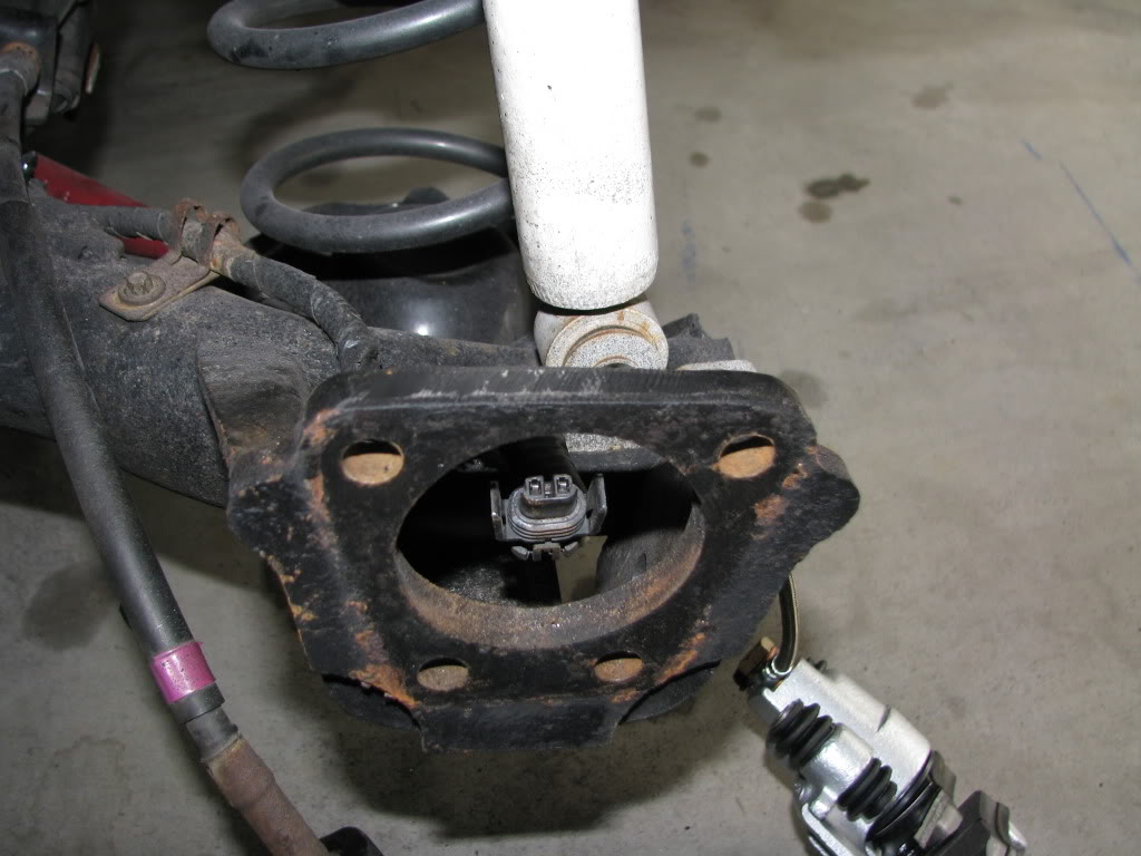

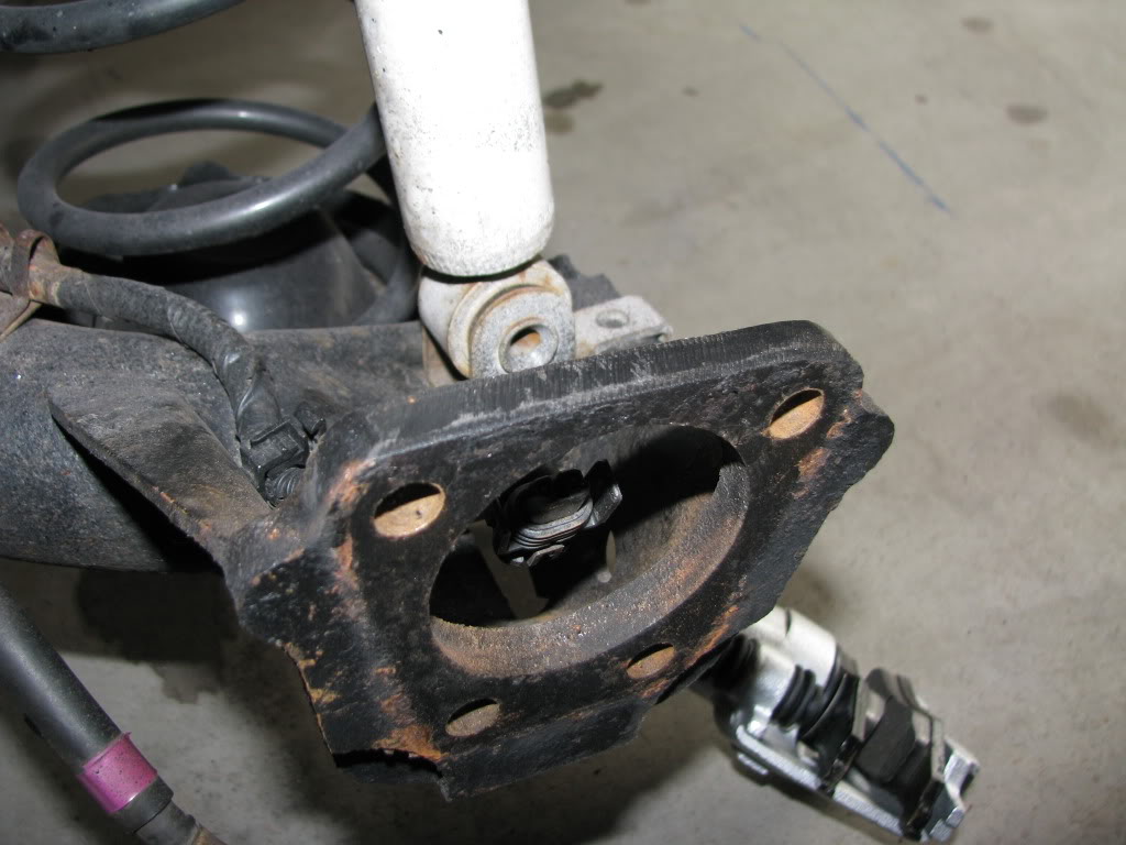

The two modifications you need to make.
Grind down the top of the mounting bracket so the Neon bracket will sit low enough for the holes to line up.
And I also cut the hook off the end of my e-brake cable so it fit in there better. I'm not sure if I had new pads if it would have been tighter, but after I did this I did end up having to adjust the cable in a good amount before it started to grab, so I really probably could have left it.... But I reused what e-brake pads came with the setup.
I will also try to copy over the write up from the J-body board and start a new pinned topic to replace this one.
Brake fittings used 3AN to 10mm x 1.0 NON inverted flare... Uses factory GM bubble flared lines to a -3an line to attach my 26" -3an to 7/16 banjo. I also used these adapters up front do do my 20" lines for the big brake setup.
Fed line through rear subframe assy, nice clean install.
I used 5 7/16 stainless washers to space the rotor out a tiny bit so it wouldn't touch the dust backing plate. Our bearings are slightly shorter than what the neon had there so you need to space it out about .080" This has also pushed my wheels out a good amounts, so I'll have to look at rolling my fenders some how and I'll have to be careful not to crack the paint on the inside edge... since once that happens it can start to flake off and could work its way around to the outside where its visible.

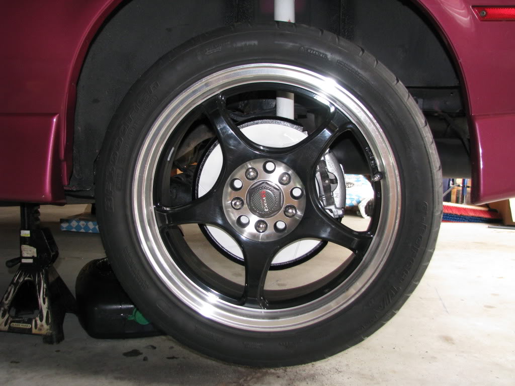

4 wheel disc FTMFW!
Finished product

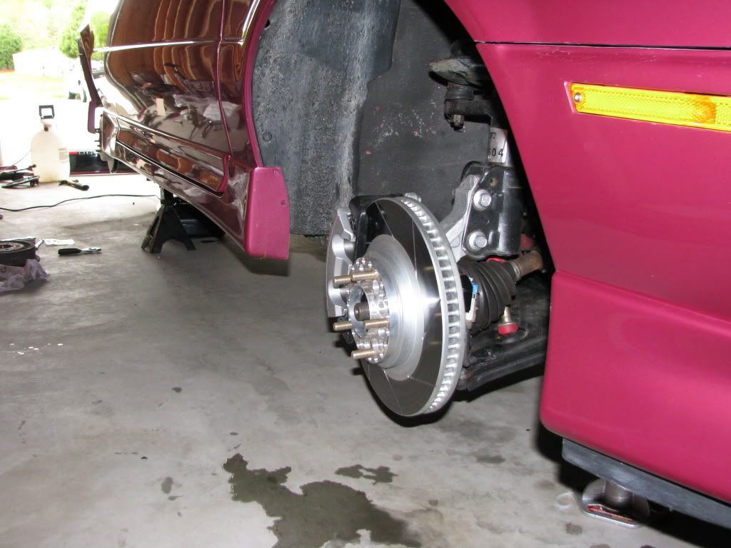

hell this is my change...
Knuckles
Stock - 9.7 lbs
N-body - 4.1 lbs
Hubs
Stock - 5.4 lbs
N-body - 7.2 lbs
Rotors
Stock - 11.6 lbs
F-body - 18.7 lbs
14lbs alone on the rotors... That's a big increase and will hurt acceleration some. People get excited about removing 1-2lbs of rotating weight... this will add 7 to each wheel, and who knows how much to the rear.

Images of bracket, Notice orientation of the bearing holes, wide on top narrow on bottom for the bearing so how they are orientated you can get an idea of where the caliper would sit.
