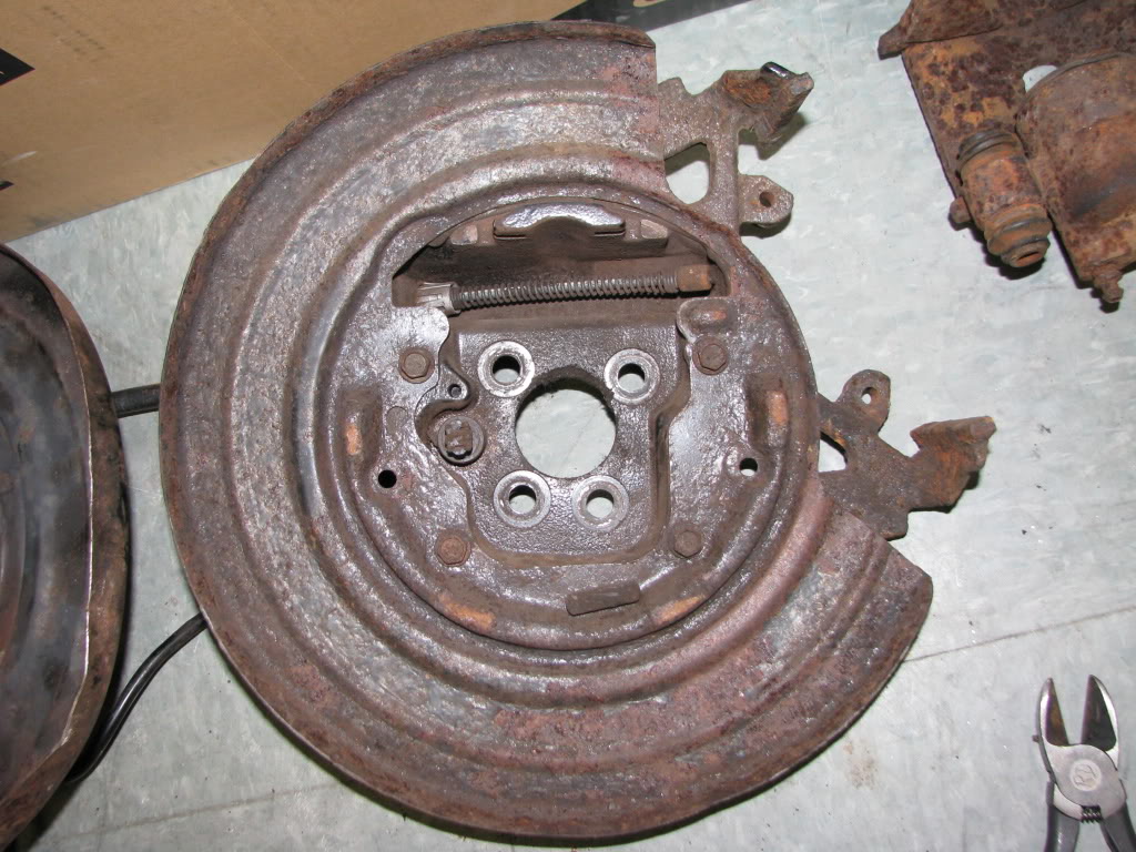

im goin with the lebaron set up, since the backing plate and caliper bracket are one piece, instead of having one made for the car.
91 Beretta GT26- GT/Z26
beretta

i have a full rear setup i pulled from a 2000 300M and they look like it could be made to fit, they have anti lock and where the censor sits is a hump in the backing plate might make it a tad harder to machine for the wheel bearing/hub to fit into..
So why neon brakes ? is the bolt pattern the same as the beretta 5x100 ?
1 problem i see with the 300M brakes is they might be a different bolt pattern and the 300M has 17 inch rims factory, might be not fit a 15" rim over the brakes.

beretta wrote:i have a full rear setup i pulled from a 2000 300M and they look like it could be made to fit, they have anti lock and where the censor sits is a hump in the backing plate might make it a tad harder to machine for the wheel bearing/hub to fit into..
You use your factory beretta bearing, but yes the Neon is a 5x100 pattern so the rotor fits fine. Also this is the closest thing to bolt on with almost all stock parts and very little modification needed to make it fit, and wear parts are avilable over the counter.
Ask the J-body guys really... I found this on their website and went with it. It had the two things I wanted... a 10" rear disc, with a DRUM parking brake.
The 300m is a 5x115 or 114.5mm pattern... Not 5x100mm.
ClonedGTZ wrote:im goin with the lebaron set up, since the backing plate and caliper bracket are one piece, instead of having one made for the car.
Explain your last statment... I had nothing "made" for the car... Only the bracket machined out to fit the bearing. The rest is all factory parts.

Postby Barry » Fri Feb 04, 2011 12:38 pm
The neon bracket and backing plate are 1 peice as well...
Posts: 10657
Location: Plainfield CT
Has thanked: 12 times
Been thanked: 46 times
Re: Neon Rear Disc Brake Upgrade.
Postby 3X00-Modified » Fri Feb 04, 2011 12:38 pm
Barry wrote:The neon bracket and backing plate are 1 peice as well...
No they are not... they are two pieces...
Without backing plate installed.
With backing plate installed.
