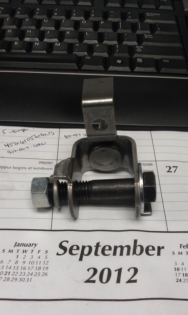

To use the Thunderbird shocks above you will need to purchase some cheap aftermarket shocks they come with a lower bracket to mount them. Just narrow the collar on the shock by a tiny amount to fit this width and your good to go. Only difference between the Saab's and these Thunderbird ones is the valving is a bit more aggressive and the lower mount is a 14mm bolt vs a 10mm bolt.
Lower bushing is also 41mm wide vs 36mm. Hence the need to narrow it to fit the bracket.

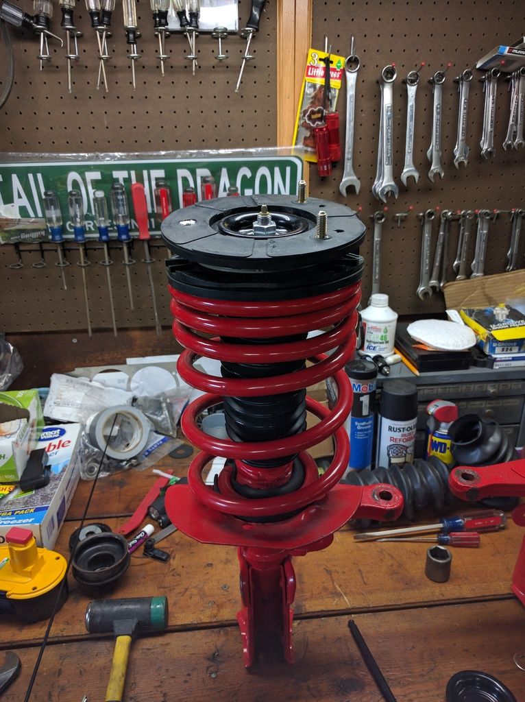

WELL I finally got some free time to install the Koni's that have been sitting around a couple months. I used a set of OEM Delco struts from a 1996 Base (Daves base)
Here are the pics
stock strut
measure 40mm
cut the old cartridge out
remove cartridge from housing and drain oil
grind sharp edges
drill big hole on the bottom to accept the bolt
You will need to make a bushing to fill in the gap, exhaust tubing works well
Install Koni yellow adjustable strut cartridge
The strut housing will be sandblasted and powdercoated. Thats why I didnt post finished pics. Otherwise I would grind the rust and repaint.
Reinstall spring, then alignment and enjoy.
Pics to follow someday hopefully.
Found some pics on the J-body site... filled in what I could and I will be updating it with my progress of my install when my inserts arrive.
EDIT 6-8-16

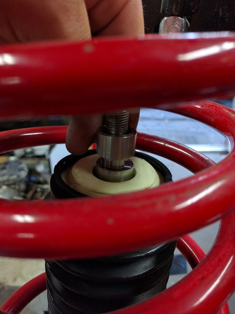

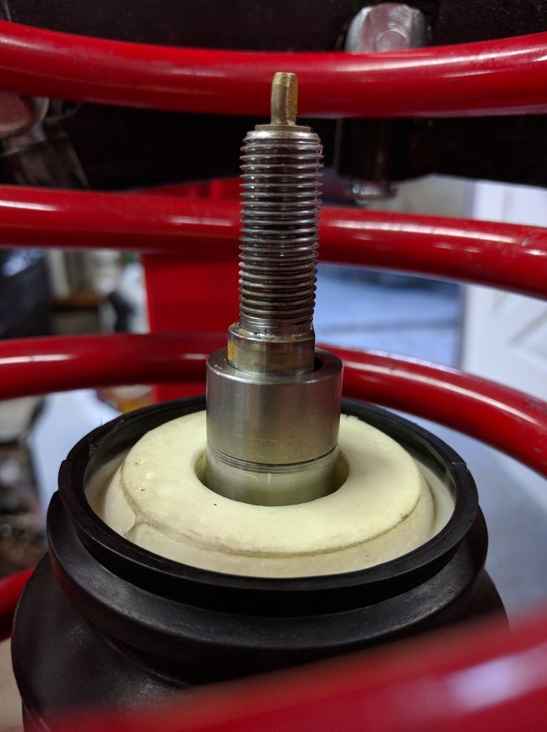

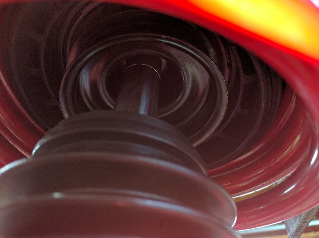

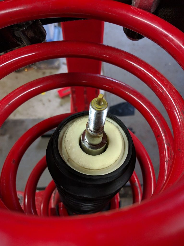

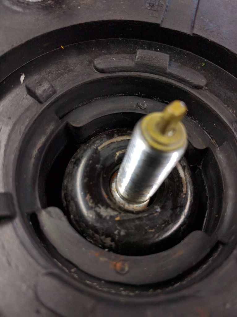

Pauly recently did this with the Mitsubishi inserts and the total cut off for the strut housing is 64mm vs the Koni measurement of 40mm. These inserts are shorter than the J-body's. This ended up with a insert stickout like this.
You want to have at least this much of the insert visible.

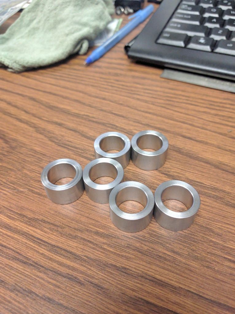

In conjunction with the longer cut to use the mitsubishi inserts you also need to compensate for the different top thread vs the older J-body versions. There is a step that messes with how the top hat fits everything and you need one thin bushing to take up that extra space. Bushing is 0.855 OD x 0.590 ID x .500 thick. The other sleeves that I was selling to weld into the strut housing also needs to be tighter since the Mitsubishi strut housing was a smaller diameter.(dimension coming) The J-body ones are larger and if you use the older sleeves then the insert will move around some which is not good.
Spacers you need for the top hat's
Where the spacer goes.
With Top hat installed.
Completed strut
