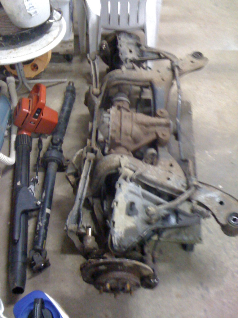

Heres a picture of my grandmoms leaf blower. She has a heated garage so I am working there this winter. I dropped the car and the parts off tonight. No pics of coilovers at this moment
