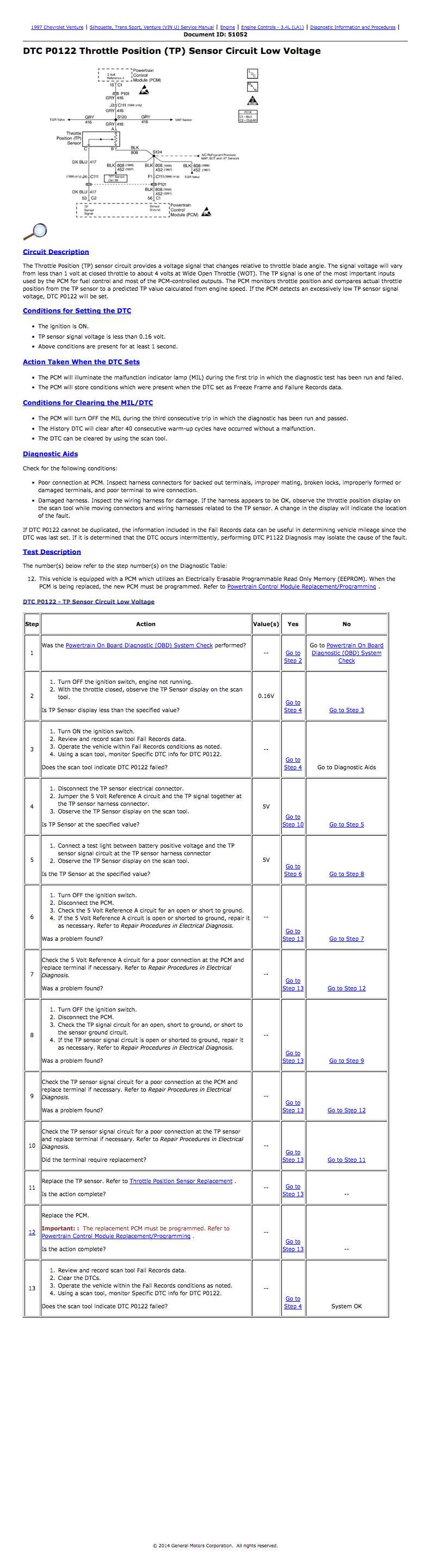

1655 can be ignored because you didn't tell me you were removing the Evap system so I never disabled that code, I will do that at Bfest. The 1200 I've never seen tripped before but I've also never had injectors go bad. I'm concerned that it could be an issue somewhere else though and maybe just a short... But it could be a bad injector. And the TPS code you need to figure out ASAP... that's very critical when it comes to 90% of how the car runs, if it's seeing a very poor TPS signal then a lot of your tuning will be off and you will get hesitation when you step on the gas as well as erratic idle and such.

3X00-Modified wrote:1655 can be ignored because you didn't tell me you were removing the Evap system so I never disabled that code, I will do that at Bfest. The 1200 I've never seen tripped before but I've also never had injectors go bad. I'm concerned that it could be an issue somewhere else though and maybe just a short... But it could be a bad injector. And the TPS code you need to figure out ASAP... that's very critical when it comes to 90% of how the car runs, if it's seeing a very poor TPS signal then a lot of your tuning will be off and you will get hesitation when you step on the gas as well as erratic idle and such.
I changed the TPS sensor and the code still gets triggered. James and i have no idea why its still there. I have erased the code after we replaced the sensor and it keeps coming back. Not sure if it has something to do with the TCE tb or what.
The evap system is getting installed this weekend also. I have everything except for one line that I am picking up from the yard.
Do you have any input to fix the TPS? Its annoying lol

I will see if James can look at that otherwise I don't know.3X00-Modified wrote:It's more than annoying it can be detrimental and dump the ecu in limp mode. I'd start by checking the wiring harness really good for continuity to the ecu from the sensor.

Had my TPS's main power wire break at the connector. It was down to just a few strands. Lucky for me it was easy to see once I checked into it. The 90GT had TPS problems so the first thought was to change the sensor. That seemed to help an then it was back to acting up. I gave the wires a tug and out came most of the power wire. The ground and ref wires were still good and I guess they were holding the power wire in place.

That's pretty good for a generic scanner like that to have that good of a description. Can you view your PIDs and see what your TPS value is? Maybe the minimum air flow rate is set wrong?

I'm not sure. I am going to set up my DHP so I can see what its reading with that and have James check over the wiring.Cliff8928 wrote:That's pretty good for a generic scanner like that to have that good of a description. Can you view your PIDs and see what your TPS value is? Maybe the minimum air flow rate is set wrong?

Make sure you investigate that TPS issue otherwise you'll just be chasing your tail.

Didnt get as much done as I hoped to today but did get the TPS issue fixed, evap installed and the new injectors in. Its a whole different car now has way more power than it did before.

Well you can't post that the tps issue is fixed with telling use what fixed it?!?

Sorry it was a long day with everything that was going on outside of getting the car done. Found bad wiring so cut some wiring from my parts car and soldered it in. No check engine light at all now. Throttle body was adjusted also and doesnt stick anymore so to say.
