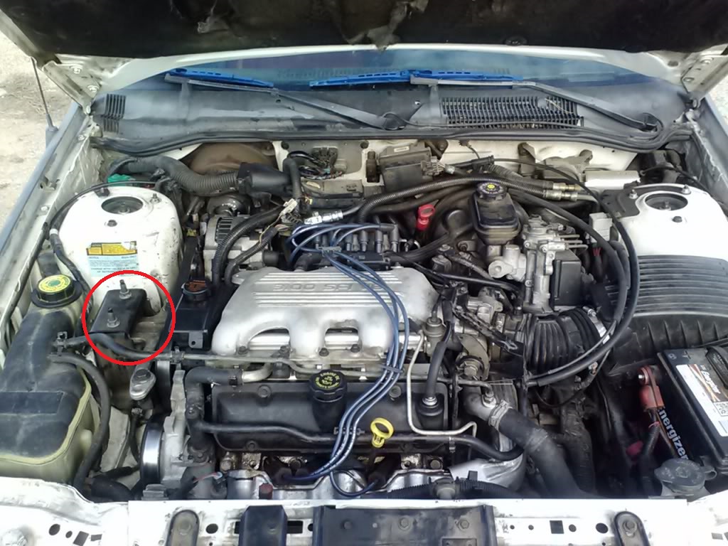

94 Z26 3.1 Auto need motor mount pictured inside red circle on picture below Only thing is I need it by next Tuesday let me know if you have a excellent used or a nos item Thanks anbd have a great day

I saw your other post too. You can get one from Rock auto or Ebay.
Just make sure you get one for the V-6 engine.
That insert fits into the metal mount "cage". But as I recall mine didn't fit so well.
I had to drill out the holes for the bolts because they were a little off.
BTW, the aftermarket units transfer more vibration than the OEM.
But it's not bad. It may seem to you that your engine idles a little rougher but it's the mount
transferring more vibration.

Here is a youtube video of a 90 Beretta engine mount changeout.
At about 8-1/2 minutes in, he shows the rubber insert inside the cage.
It is similar to the 94 Beretta.
https://www.youtube.com/watch?v=zsTjQm4-Dsk
I would drill out the rings on the bottom instead of chiseling.

When I bought my car, it also needed this. It was completly trashed, so I had to buy the complete mount, not just the insert. I had trouble finding it too, as it seems to be a 94 only part. I had to get it through my local gm dealer, and it costed almost $200. I tried the duralast brand one and it didn't work. Where are you located?

his location is in the comment of his picture
North Central Ks zip 67432
Ebay shows the part number is the same as my 96.

it is a 94-96 part yes the aftermarket ones need to bore out the mounting holes. Any Autoparts chain should have it
