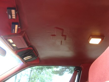

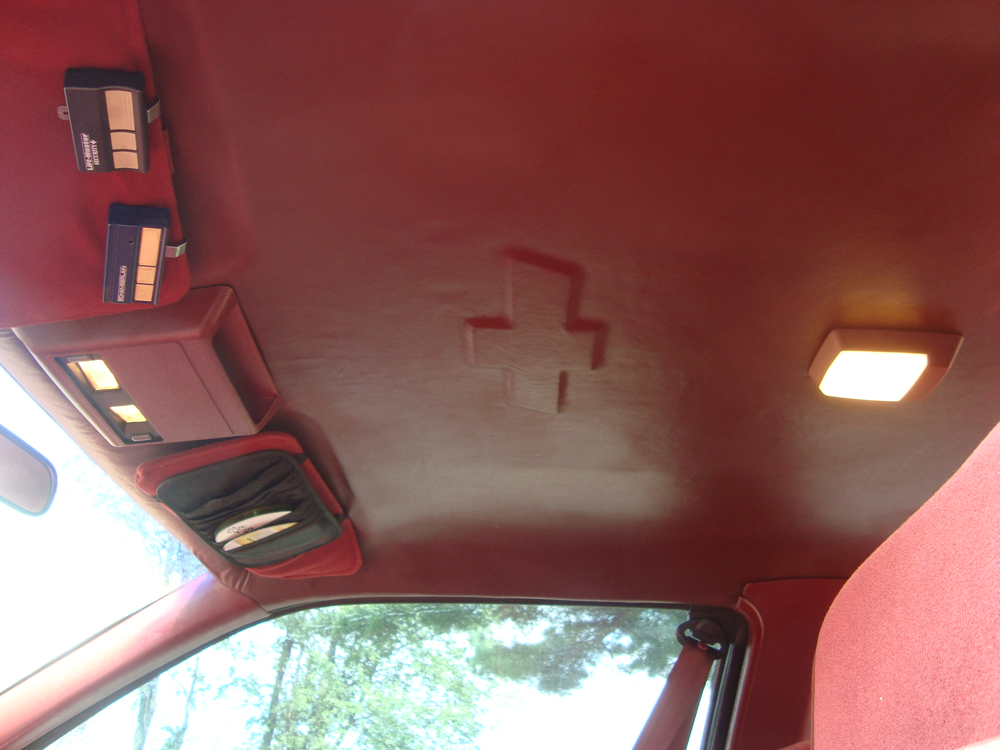

Postby Thompson128 » Sun Jul 10, 2011 3:45 pm
Thanks for the guide barry, i think mine turned out great, just so happened that my local craft shop had 7 colors of vinyl and this was one :D
Barry
Posts: 1869
Location: Hatfield Pa
Been thanked: 1 time
Re: How To: Re-do your head liner
Postby Barry » Sun Jul 10, 2011 10:54 pm
Very cool chevy symbol. Did you cut it out of foam?

Barry wrote:Very cool chevy symbol. Did you cut it out of foam?
Yeah two layers of some cheap walmart craft foam with the sticky back
