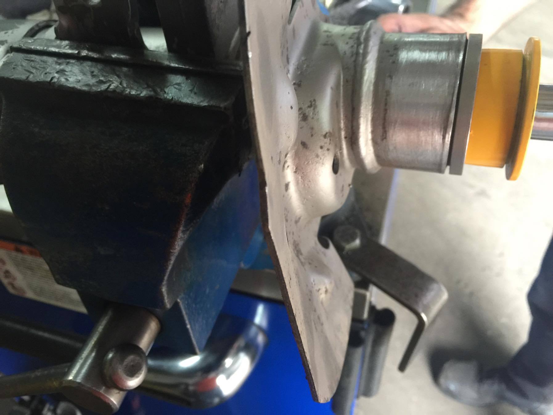

Postby 3X00-Modified » Wed Jun 08, 2016 2:49 pm
Pauly recently did this with the Mitsubishi inserts and the total cut off for the strut housing is 64mm vs the Koni measurement of 40mm. These inserts are shorter than the J-body's. This ended up with a insert stickout like this.
You want to have at least this much of the insert visible.
