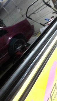

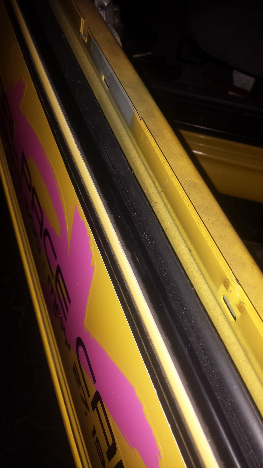

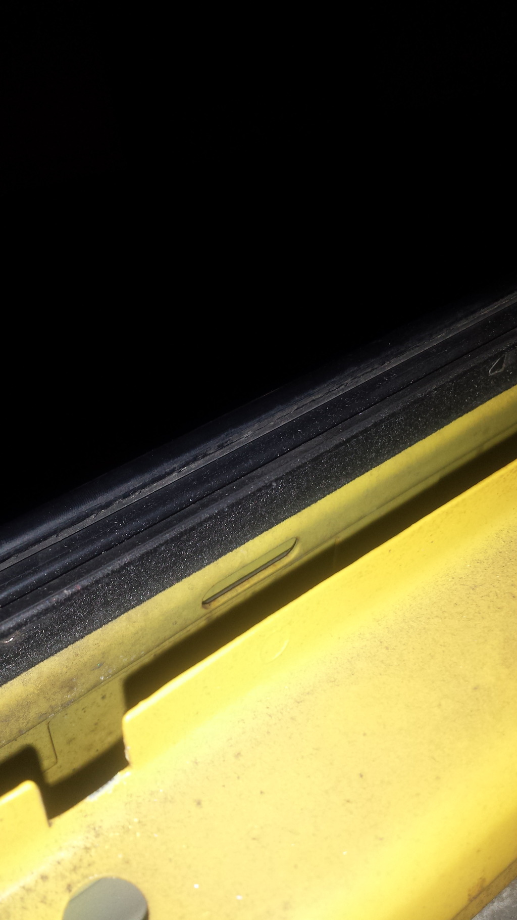

New Fuzzies for the windows!!!
These are Universal dew strips made from universal belt weather stripping... The best replacement other than finding a new original soft set hiding somewhere.
Restoration Specialties PN MR87X 96. Belt is $32 and they may or may not be able to deliver to your house... most recent order I have to get shipped to here at work. Not sure why.
I will get a better picture when the window is all back in... I will advise though... Do not attempt to tint a window when its horizontal... No matter how hard you try you end up with dust all over it since the surface is flat vs being vertical where nothing can fall on it after cleaning it. I did two windows last night and I'm disgusted with both... I will probably pull the tint off the original glass and re-do those with some more film but position them so they are vertical... Every Subaru I've done has come out better than this so I know it's gotta be from the technique.

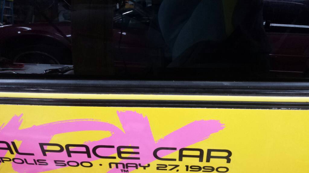

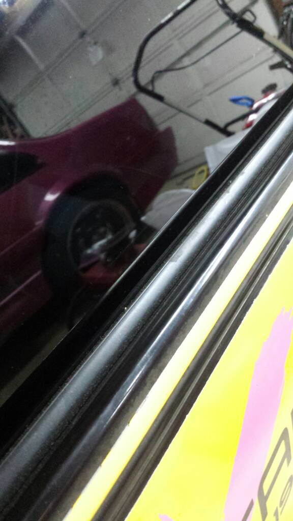

Guess I should update this...
They fit like a glove
