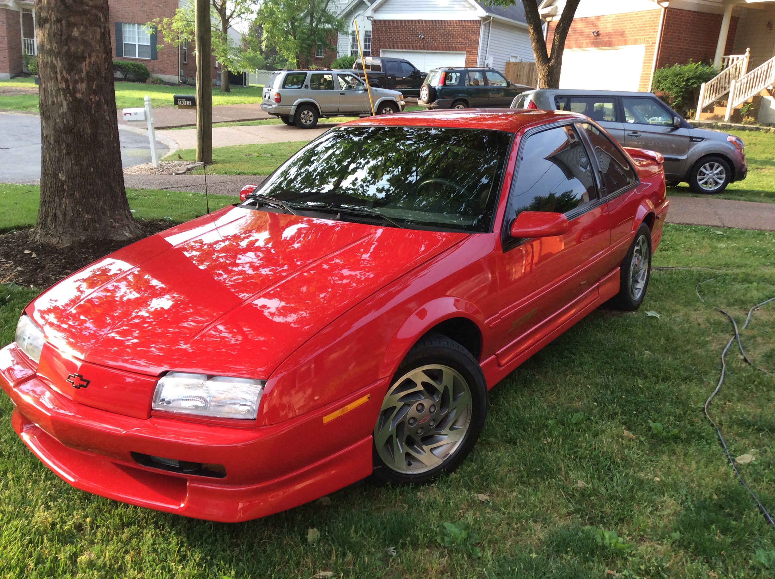

Here goes, I have a 1996 Beretta Z26 has 37850 original miles on her/ Has been sitting for years. Long story, bought it from an estate sale. Of course all fluids changed, belts, tires everything. Has exhaust coming out of coolant, no other signs of head gasket failure, no milky oil, no exhaust smoke etc. I have 3000 in it after paint work, I don't want to put another 1.5 k-2 k for heads, unless I wait about a year. are there any products anyone would recommend to quick fit, I know they don't always work, but its scrap pile or quick fix help!
pic of my 96 z26
pic of my 96 z26

Either that or post some pics of the ruddy thing, and it will sell on here if it's legit.
Just my .02 and better than the $300 you might get for scrap.
Re: Need feedback on Z26 blown head
That is one good looking car. Hope it is saved from the scrapper.

3. Place the car for sale/offer here and attempt to recoup most of your investment thus far. The GTZ/Z26 is the most sought-after factory trim, and the 1996 production year in general is desirable. There is no doubt in my mind that, (barring any issues such as rust/rot), it should sell quickly.
Should you decide to go with option 3, please provide us with your location and many, many pics!
