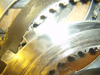

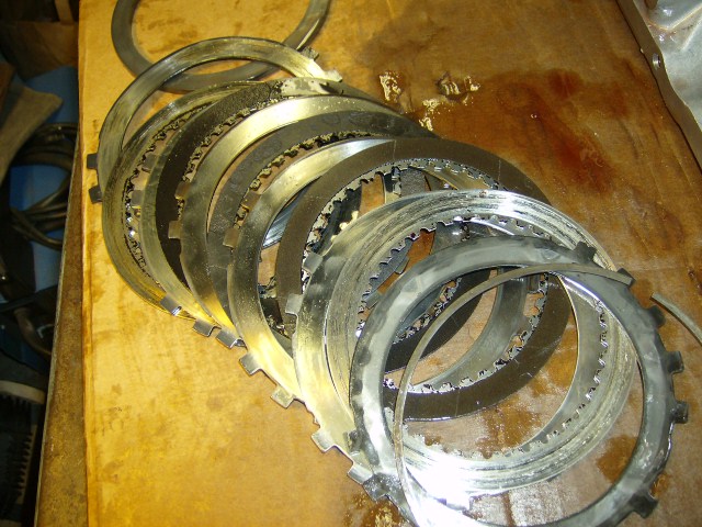

From my pic at the beginning of this post, I believe the wavy plates cause excess wear
to the lo-reverse friction discs. You can see how the friction against the wavy is the worst and the center discs are thick but chipped. What happened is, with the friction material gone, the piston reached it's maximum travel and would
not compress the clutch with enough force for it to hold. I could see the marks from the return spring bottoming out.
I decided to eliminate one wavy and put a used steel in-between the wavy and the friction. This would make the pack too thick so I used a surface grinder to grind about .007 off each steel so the over all pack will be thin enough. Now my lo-reverse frictions are up against a flat steel plate instead of the high points of the wavy plate. I'll probably be worm food before it wears out again.
