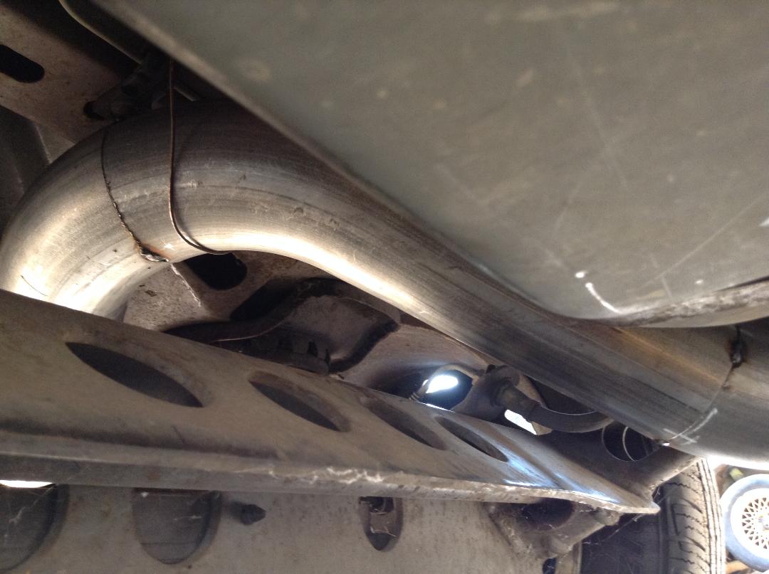

I got the exhaust-pipe done out to the muffler today. The car is very loud with just the turbo and a Flow-Master 3" in, dual 3" out muffler. I do believe the "Twin Dual" (haha!) Z-26 resonator tips will help tame it down a little. I had hoped for something a little quieter than my GTU, but I didn't want a restrictive exhaust, so I guess I can't have it all...
I angled the bend over the rear suspension beam a little further towards the center of the car, the bends were a little less extreme that way, and I have enough concerns about the suspension clearing the 3-inch pipe without cutting corners, as it were. Here are some shots of the pipe tack-welded during fitting...

I got most of the rest of the exhaust done today -I still have some clean-up work to do, a few mounts (3-inch thick-wall aluminized tubing is heavy!), and will likely paint at least the weld-joints to slow any rust that might get bad ideas..
The right-side exhaust-tip assembly had to be modified to turn it into a 'right' side, it turned out pretty good except for the lack of scalloping on the bottom edge of the rear bumper-cover on that side. I decided to live with it rather than cut or heat a perfectly fine bumper-cover, so that tip sits several millimeters lower than the left -oh well, it still looks good and sounds good -those tips saved the volume-level on this car!
