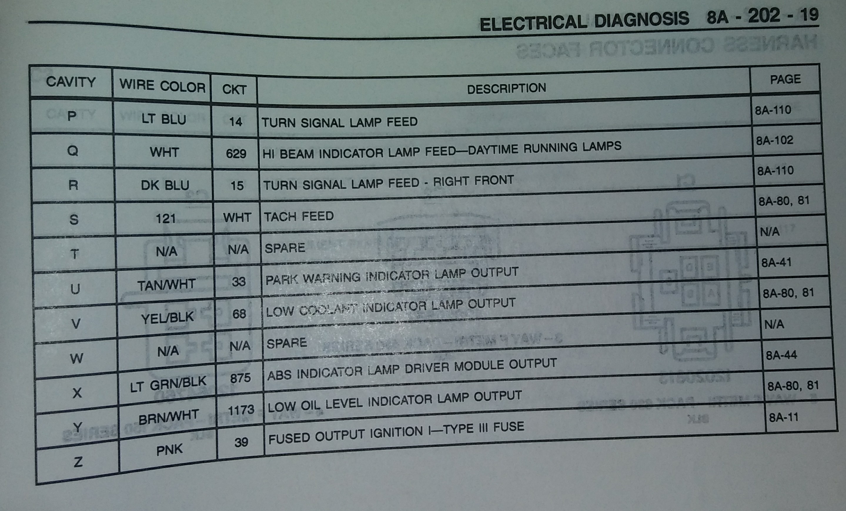

One thing I'm thinking is how to make the serial output for the cluster to read. I don't think the OBD2 ecm has that capability. However It shouldn't be too difficult to make it with a Pic18 or an arduino, I think it was a standard output.
Below are a couple photos of the 96 Beretta gauge cluster connector electrical pinnout if you decide to adapt it to your car: And just in case, this is the digital cluster connector pinnout info from the book:
