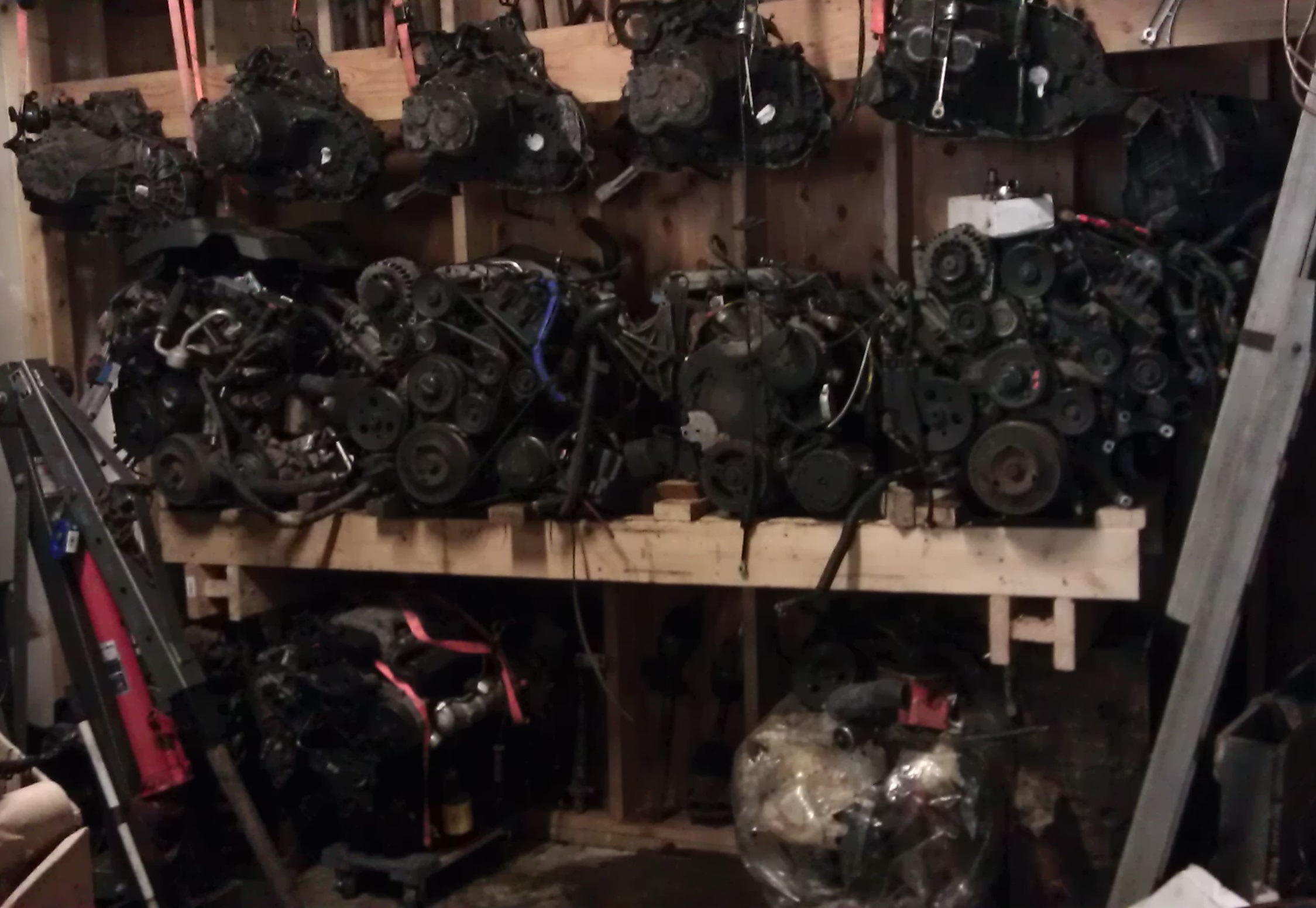

I needed more storage space for some of the larger spare parts, i.e. engines and transmissions/transaxles. I had a pair of old Chevy straight-six engines sitting around and rotting (not worth rebuilding to me, both came with the house when I bought it), so I stripped them down to the blocks, and they became the base for my new engine-rack. Initially, I had intended to make a vertical 'tree' for the transaxles, but I like this 'beam' much better -no additional floor-space used! The beam is solid, supported on each end all the way down to the floor and boxed-in to keep it from trying to twist forward, but since the weight is all overhead, I wanted to add straps up to the rafters just as a backup precaution.
5-4-3-2... The straps on the transaxles are just an extra safety, since they are overhead.  Hard to make out the differences in the pic, but the far transaxle is a very rare Muncie 284!
You can't really see them in this picture because my 'little' hoist is in the way, but there are a pair of RWD five-speed transmissions stored on the far side of the engine rack, and I pushed the 5.7 TPI L98 from my GTA Trans Am in the empty slot under the rack right after taking the picture, so... Five transaxles on a beam, over four engines on a rack, with three engines underneath, and two transmissions to the side, and a partridge in a pear tree! I still need to do something with the engines sitting in the next bay too... :P

Man, that looks like it was a lot of work but worth it.
How big is your shop? How did you get those trans-axles up there?

I actually really enjoy engineering things like this, then making them into reality, so it was fun. The shop isn't real huge, a couple of bays and a workshop. It will be nice when the next 'upgrade' is finished, and I'll have an extra spot in there :twisted: . The transaxles weren't too hard -I have a couple of engine-hoists, and I made an extension arm for the small one -only safe to use at max reach with lighter loads and I also have to calculate the extra force on the hydraulic ram, but those trannys only weigh about 80 pounds +/- (the 284 is closer to 95, I think). The little hoist actually reaches that far normally, but the legs are a bit long and start interfering with the back wall once the arm is cranked up so high, as it is also pivoting backwards at that point. The extension just makes life easier. "One of these days" I will make it a 'live-load' adjustable arm, with thrust-bearings and a crank handle, that has been on my drawing-board for a couple of decades...
