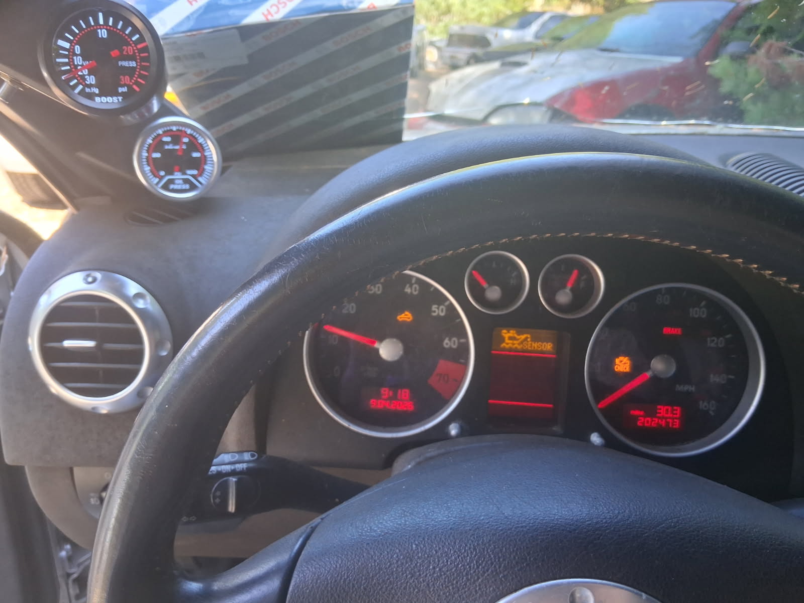

The latest round of Zelda issues reads something like this:
-Fabricated the Oil Pressure Sender TEE out of some fresh one-inch brass -cost maybe 1/2 of simply buying the adapter online, but this way I know the machining is to my standards with no porosity in the brass, the main plus of course is that I enjoyed making my own part. Built, Not Bought for the win!
-I also made an extension tube to make the new gauge sender easy to access, instead of the Audi way of 'cram it in tighter!'
-The dual-gauge setup on the pillar works great. El-cheapo gauges setup with an independent dimmer mounted right on the pillar, and aside from needing some textured vinyl and a stiff backing panel to finish-off the pillar (I am unwilling to cut up the original pillar-cover as they are getting pricey and harder to find in good shape), I am very pleased with it. Running the signal wire and vacuum-tubing was pretty easy, but took a little longer than needing because of how I chose to do it, keeping modification to a minimum and as discrete as possible. This is how it came, of course, nothing to see here, tra-la-la...
--The new sensor is in, but the instruments still show a pressure-sensor circuit-fault. Time to trace wiring, I guess...
--The oil pressure is fine at start-up, but slowly fades off at idle as the engine warms, and pulls up fine if revved a little. Mmm, [i[could be[/i] a worn-out oil-pump, but this to me is definitive worn main bearings. Chime in for me if you have other insights please!
