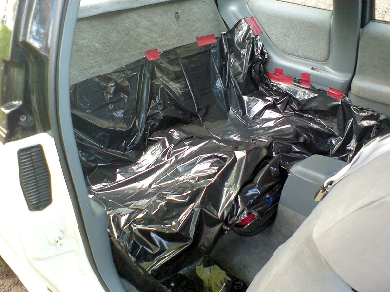

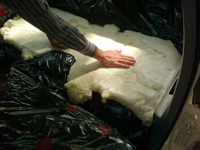

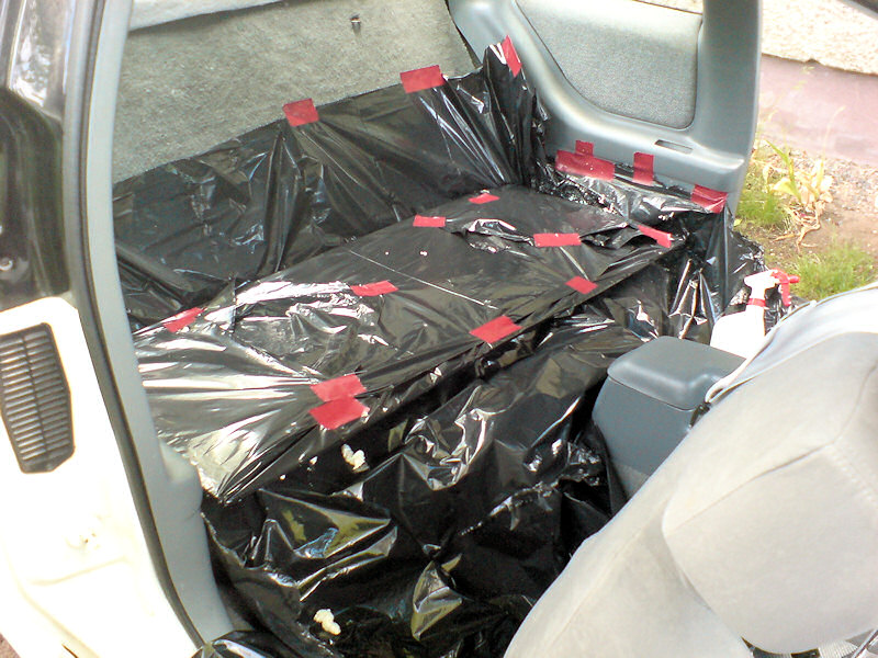

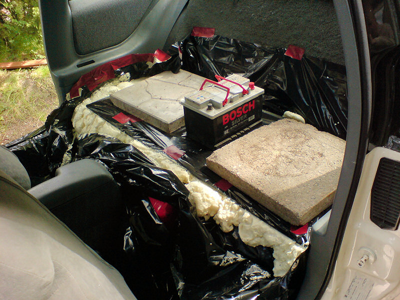

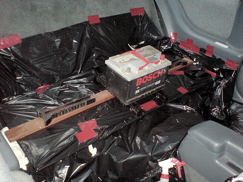

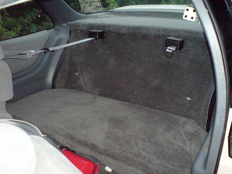

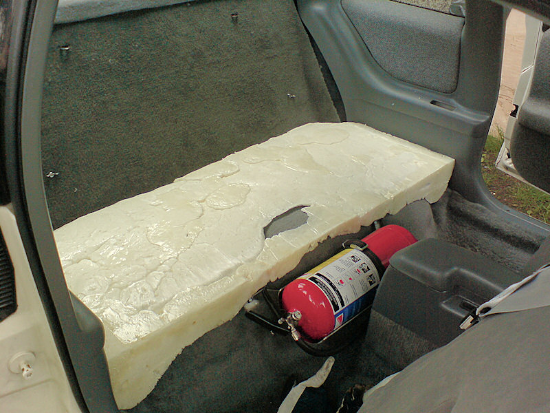

I got bored seeing the ugly metal surfaces and empty seat belt holes here so I put new carpet to back there, It's not done yet but almost there.
All that carpet would also be good for echo cancellation... I wanted to make the 'rear seat' flat surface, but also make it Light, so i thought about using urethane instead of plywood or something like that.
Never actually done anything like this before, but hey, there's a first time for everything.. ended up acceptable, not show quality by any means... :D
Work in progress pictures 1 2 3 4 5 6
I need to lay some carpet over the black parts too.. and cut and fit the pieces better.. but what do you think?

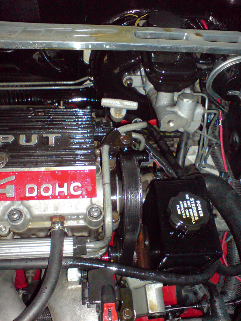

- Camshaft gasket blew away after some shift_7400 action, spraying oil all over the engine bay and that cause some smoke to raise from the hood scoop, waking up my attention.
= I traced it down to possible overpressure in crankcase, did major re-work to the external breather tank piping to triple the volume of it, my own design flaw right there...

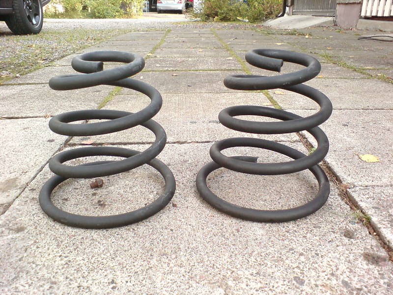

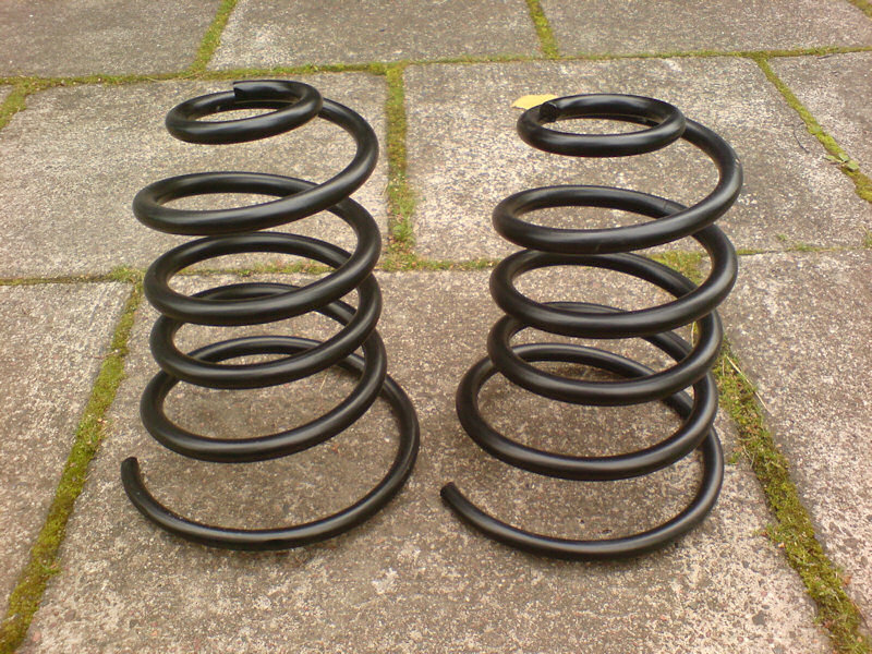

Since the Sprint rear springs failed on my black car, i decided I'm just going to use the (way) too soft Eibach rear springs from the white car to replace the even crappier Sprints.
Off course the white car needed replacements, so i had custom ones made to order.
I took the Eibach spring into the spring shop, and asked them to copy it, but without the progressive setup and with 50% higher spring ratio, and making all that couple centimeters lower than the Eibach setup.
Custom springs #1. Well i guess my needs were too much for the spring shop, since what i ended up getting was a copy of Eibach, but without the progressive setup.. So this still was way too soft setup for my use, so these had to be returned to the shop with clarification that i am NOT looking for any wobbly bobbly comfort ride setup.
So here is the custom springs #2, made of notice able stiffer steel and shorter design to make it work. Now Much stiffer than the soft Eibach ones. But again these were still not as stiff i wanted them to be (i can still move the rear end of the car some :( ). But since the customer service on that spring shop sucks, i decided that I'm going to run with these instead returning them, maybe they are not too far away from what i want. Also i have other plans to stiffen up that loose rear axle for the task.
Installed, height was pretty the same as with Eibach, but it should settle down, let's see how it ends up.

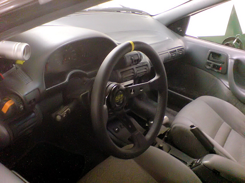

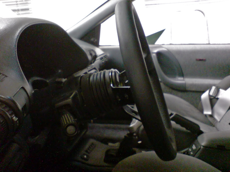

New steering wheel, I've been dreaming about installing racing steering wheel to my car for a while, but as you all know, 99% of those are wrapped in suede, and require using gloves when driving. Since this is not a track-only car, i didn't want that.
Well after long searches i managed to find one that was wrapped in leather instead, and had the 3" close-reach dish i was looking for. And also had optional horn button available (required in law here), So had to buy it.
I had to get the hub turned in lathe to make it fit with the steering column plastics, since it was rubbing them. And off course it was turned too much so now there is a gap, oh well, at least it does not rub anymore.
Here you can see how much closer this thing comes to me, just like the shifter now with the modified shift arm. Also this wheel is just a bit smaller than our stock ones, but not too small, so i can still see all the gauges. And lucky me i have long fingers so no modifications to the turn signal lever were needed, i can still reach it.
This saved some weight, cause the airbag steering wheel was 4.9kg, this maybe half of it with the hub... The red bow tie GTZ wheel is in my black car now.

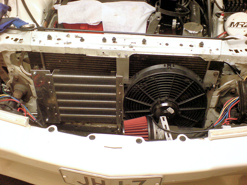

Also i got this overkill sized engine oil cooler, core size is 12"x10x2" i think and it's a good flowing design without the end tanks. Since i don't have any cooling airflow under the oil pan anymore, and i wanted as much oil as possible in the system, i went Big with this thing. It's hosed with braided steel hoses with quality fittings.
There is an thermostatic oil filter sandwich adapter on the engine side. With oil temperature gauge sender on it. I need to install that gauge somewhere on the dash still.
The dual fan installation is not perfect anymore since this required quite a much room and space behind the fan, but i have huge plans considering this area of the car, Later in the coming years..., So i will just go with the current setup now.
