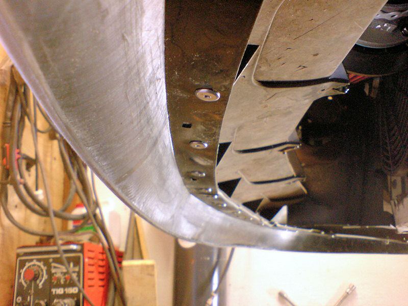

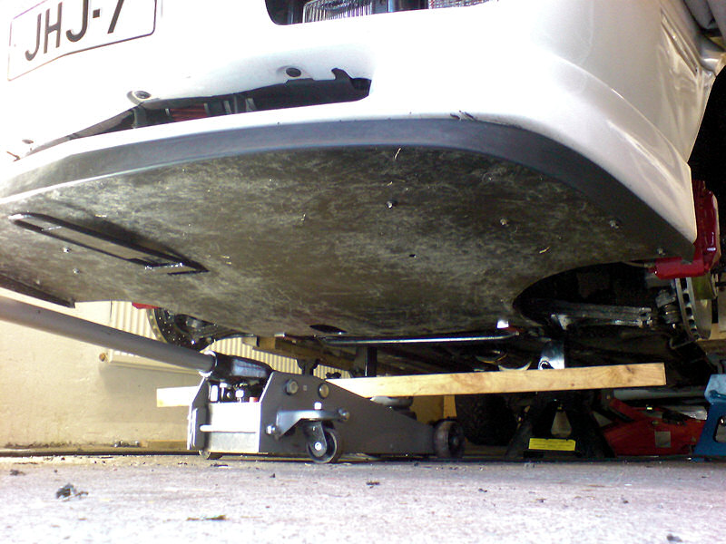

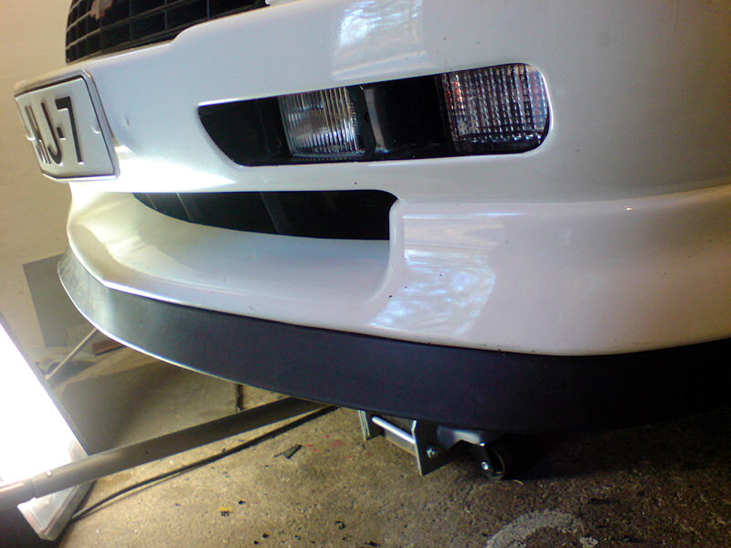

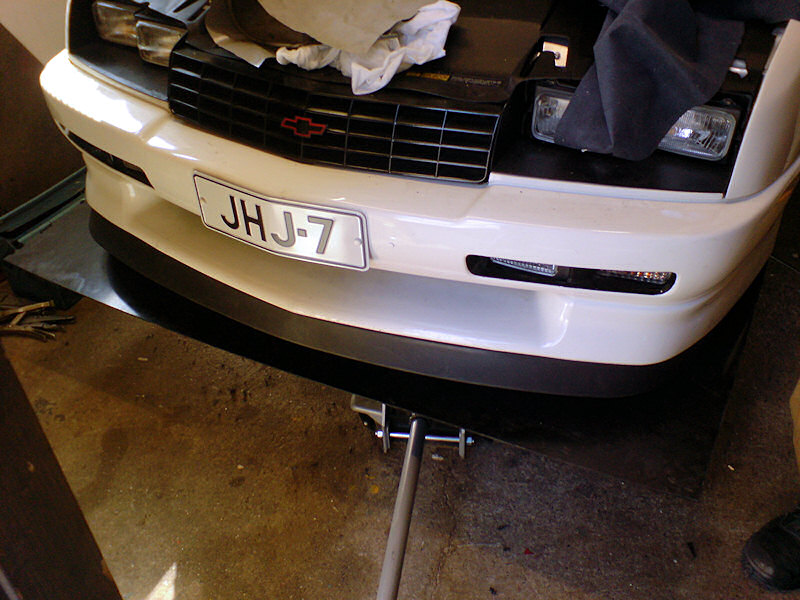

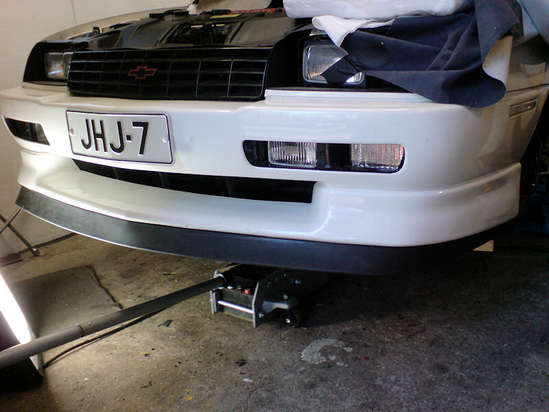

Some of the latest changes on car:
I installed Mach-1 front lip.
Figured out that cutting the mounting surfaces a bit i could manage to force it very near the aggressive shapes on Z-bumper.
The round edge on bottom of the Z-lip saves the cutting short issue, what it only does at the tightest corners,
managed to reduce that with the cuts i mentioned. I'm very happy about how it looks and fits, could had been worse.

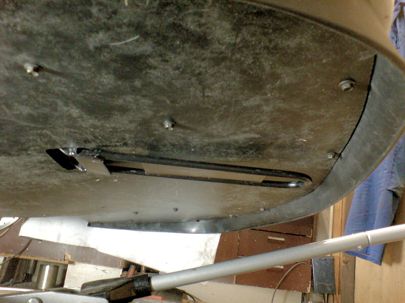

I went with flat mounting because of the following reason:
Hmm?
After LOT of fitting & cutting.
Made holes for my towing arm\hook thing and oil change, except those it's all solid all the way to passenger side axle.
This will mean Big reduction in dirt, water and other stuff inside the engine bay, protect my belt drive from stones and other unwanted items..
And take care of the thing that has always bothered me.. can't see ground anymore when looking thru Z-lip
It's not bad for aerodynamic drag either, tho high top speeds is not the thing I'm aiming my car at.

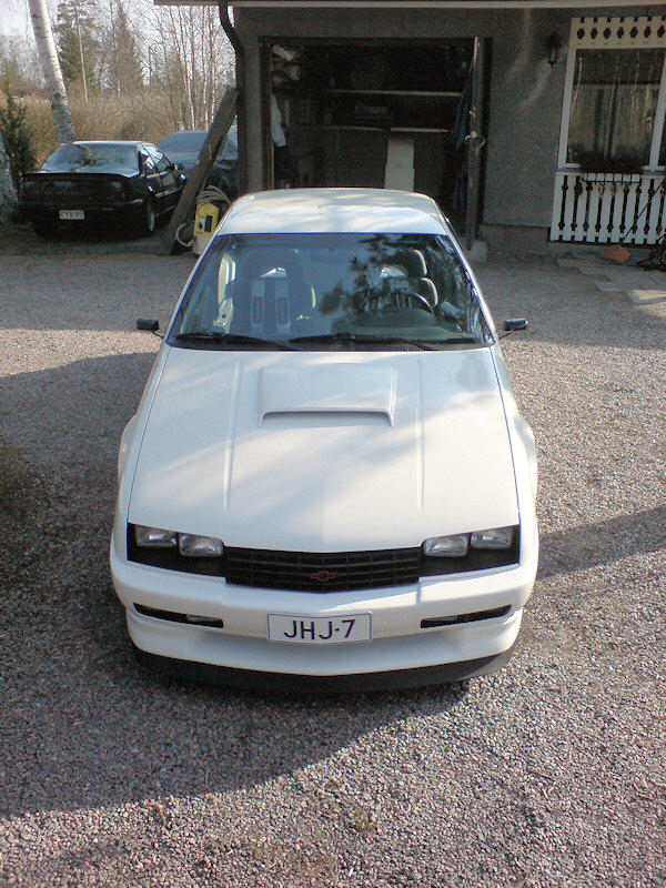

Tomorrow i'm doing some more test driving, and if everything functions as hoped, i'm heading to inspection next week! Previous one was in 2004.....

Re: the White car project
White car is now officially ROAD LEGAL!
Expect some video in near future
(and if someone of my American friends is wondering what's so big thing in inspection, well here all the modifications need to be accepted by officials / DMV, it's not that easy to actually make something like this happen legally!)
