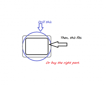

Buy a drill.

Rettax3 wrote:
Buy a drill.
That would be an easy solution if the holes were round....

Cliff8928 wrote:Rettax3 wrote:
Buy a drill.
Sorry, I really don't mean that as snappy as it comes across -it has been a long day, so please accept my apologies. But I am very familiar with the various cooling fans used on these cars, and J-bodies, and N-bodies, and I have been shaking my head over a lot of this for a while now (not this thread specifically, since it was about a battery, although... Never mind). Cooling fans are a really simple issue to deal with on these cars, if you aren't trying to make a 600 horsepower monster made to run in Arizona in the summertime, or a museum-quality 'perfect' as-built original. There are so many donor cars out there. Do watch the different radiator mounts though (I refer to the plastic and rubber "C" pads at the top of the radiator that bolt to the upper core support), as some of them located the radiator back ~1/2-3/4 inch, just enough to let it get slowly eaten by a hungry fan designed for a different radiator mount or a different thickness radiator core.
