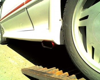

- GTU's tips -both sides are the same, but sounds weird reverberating in an alley.

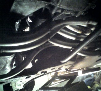

The exhaust was the hard part, mostly because I was going for a six-pipe "Hexhaust" all the way out (had several pictures of that back in the day, I did a full step-by-step write-up on the whole build back on
bstuff before it died) which was way too loud (yes, six small mufflers CAN fit under that car!) and had to be rebuilt as a dual setup.
- GTU's headers. Ultimately ended up terminating in a true dual exhaust system.

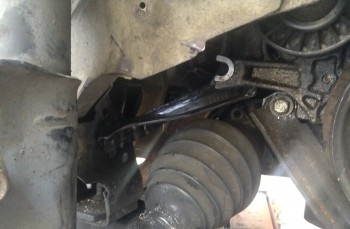

- The rear-brace installed. I still want to fab-up a plate to distribute the force more evenly to the frame-rail, and the bolt isn't tightened down yet. I also want to rubber-isolate the plate to damp-down vibration.

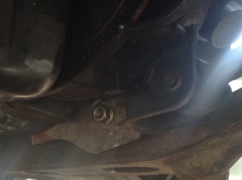

- The tranny mount. This plate is bolted to the bottom of the Muncie out of the way. The large bolt (from the original mount of an older Beretta) is pinned-down on the other end by a rubber-coated aluminum saddle that is in turn bolted to the subframe.

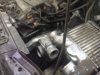

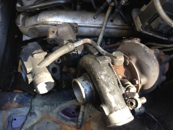

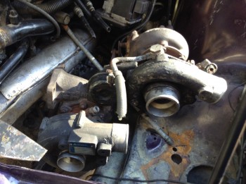

Hehehe. I am still debating on which turbo to use. I want to use the .60-trim T-4 from my '90 Turbo 'Retta, but it has only a 2"outlet on the intake side, I am wondering if this BW with a 2.5" outlet might be a better option, despite the obviously more restrictive T-3 flange on the exhaust side. It would need a custom exhaust outlet to fit this application, will need to be reclocked (hot-side), and an external waste-gate plumbed in (so would my T-4). I am also considering other options...
For the Intercooler, this 2.5 in/2.5 out Saab Blackstone is a great option. I've test-fit a few other options, and anything else I have would need to be front-mounted. Not sure I want to do that here, and even this one works great as an FMIC. I'm not planning on much boost, so even this small IC should be sufficient, especially considering how well the Blackstone ICs transfer heat (the air-tubes are NOT hollow).
- Just a mock-up. This is my BW turbo, 3" in, 2.5" out on the intake side. T-3 inlet flange.

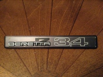

Played around with some badging options a little today. It has always irritated me that the Z-26s didn't have any special interior badging, and no dash emblem (aside from the standard tiny "BERETTA" over the center vents. This is what I came up with... Reminiscent of the overlapping writing on the Indy dash emblems, and an honest homage to the engine's Z-34 donor, I think I am happy with how this turned out. Originally, the "Z" is just painted, the "34" is raised aluminum. The decimal for the 3.4 is an actual T4 Torx screw...
- "Z34" becomes "Beretta Z 3.4", I hope.

- A good fit, really. Reclocking would be needed, and obviously a good cleaning... Finally found the car's hidden rust too, will have to cure that up.
I went through some compressor maps the other day, and knowing that I have a pair of TD-05s (the upper turbo is one of them, the K-26 on the bottom is just a stand-in for the mock-up), I looked them over on paper, and dug one out. Not too far out-of-whack for the 3.4, and it would be really interesting to run twins... But, I already pulled my far more efficient T-04 out of my '90 Turbo, and the build is so much easier with that single one. So, staying with Plan A... But, the twins do look good in there, plenty of room for them too!

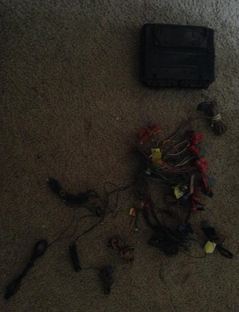

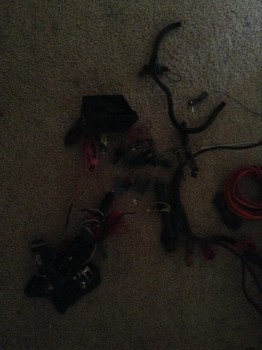

Finished stripping-down the wiring harness from the 3.4. Since I no longer have A/C
, I removed the relevant wiring to that, and since I have no intentions of EVER attaching this thing to an automatic again, those connections were also removed, except for the leads going to the gear selector switch -I need those to convince the ECU the car is in gear, so the Park/Neutral rev-limiter can be disengaged. I also retained the cooling-fan relay control leads, as I will let this ECU run the fan(s), however I decide to set those up. I've also retained the wiring going to the engine's sub-harness connectors to the EGR, just in case I want to run something else to the engine at a later date, but they are disconnected from the ECU since EgGeR will also not be back in place, EVER. Due to the W-Body cars of the era stashing their ECUs next to the engine inside the bay, I do not have a lot of options on placement unless I extend the harness, which I will not do. So, the next step is to attach everything to the engine, decide where I want to place the ECU, and loom the harness up.
- This is what I don't need from the engine-bay harness. Quite a lot!
- This is what I am keeping. Integration to the '95 Z-26 harness should be pretty easy. ALDL lead may be the hardest one to deal with, as the new ECU will not be inside the passenger compartment like the Beretta's is.

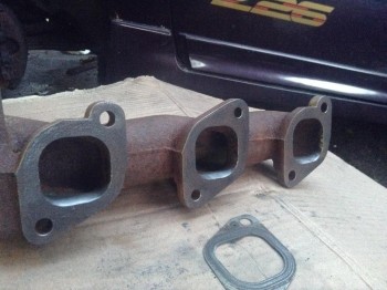

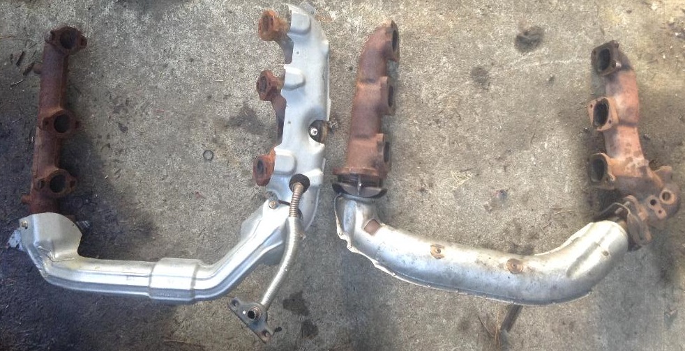

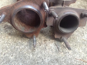

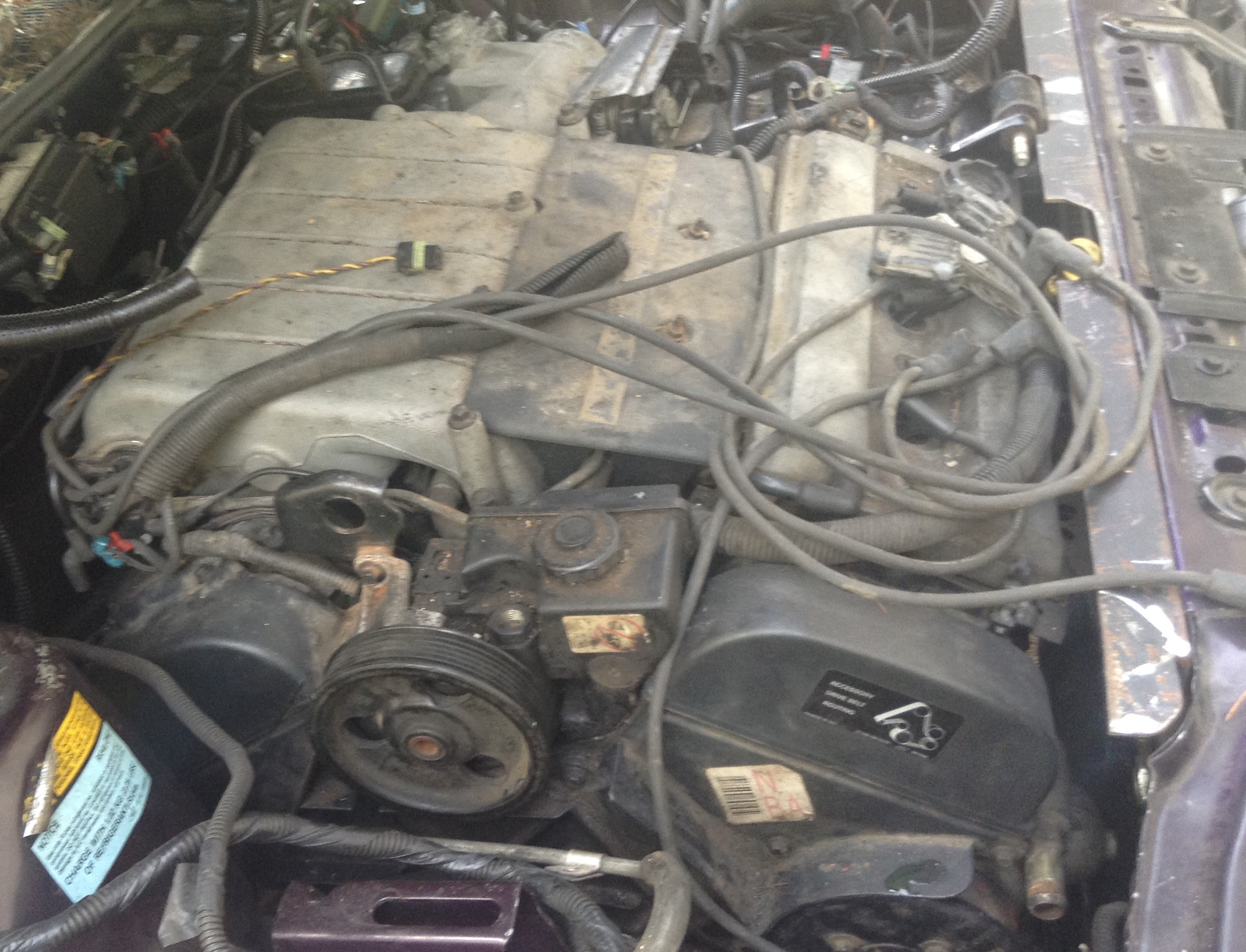

Got some serious exhaust work done today, just not much of it!

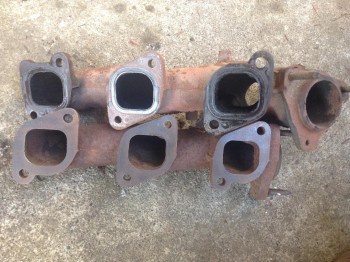

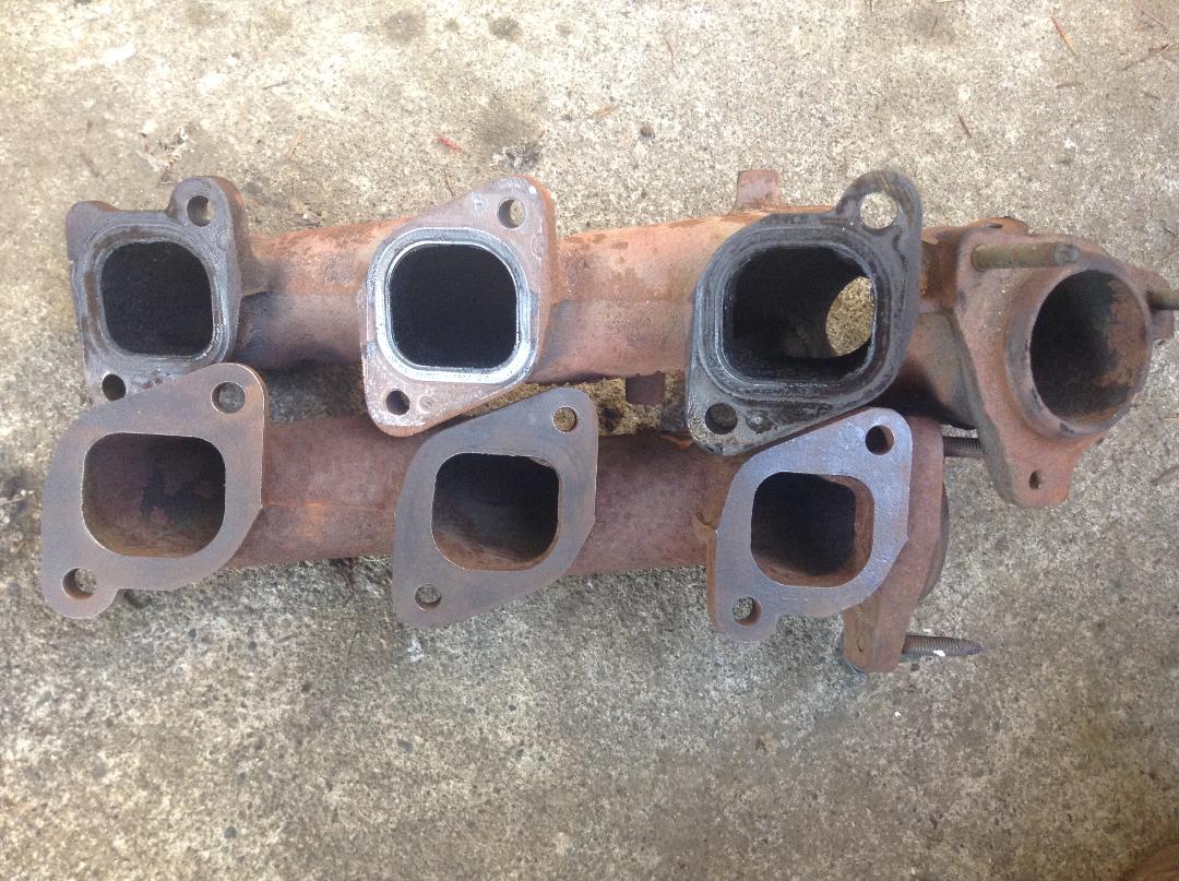

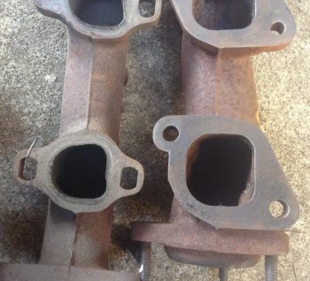

The new manifold arrived the other day, so I got the prep work done on it. I also thought some people might be interested to see the difference between the 3.4 TDC and the 3X00 exhaust system. This is why I haven't been aching to build headers for this thing -no need.
- 3.4 DOHC vs 3400. Hmmm
- ...Too bad the flanges won't line-up!
- The overall dimensions between the TDC and the 3X00 aren't very different. Despite the size of the TDC crossover pipe, it actually sits much closer to the engine

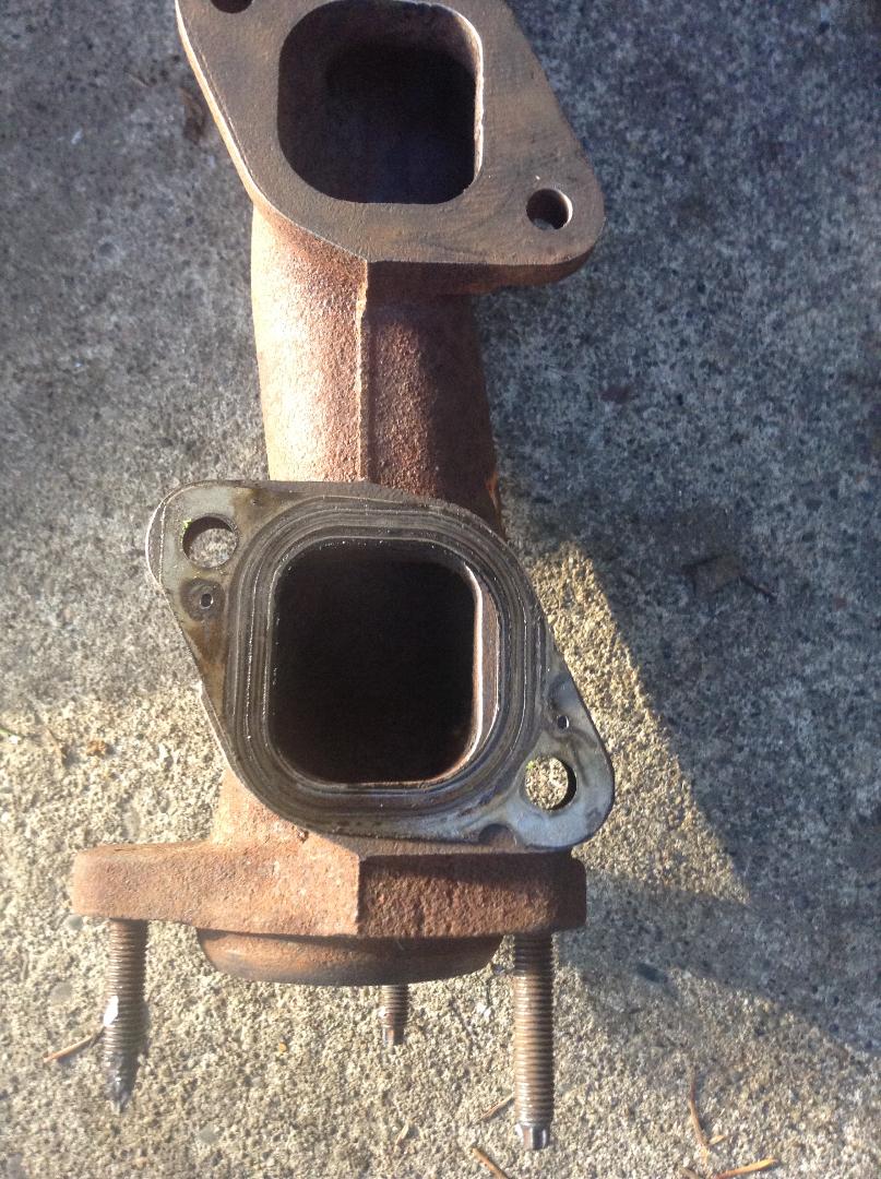

- Basically, I am flipping a second Front exhaust manifold over and installing it on the rear. This lightens everything due to the shorter casting and balances both banks, and aims the outlet towards the crossover pipe instead of away from the turbo.
- The ports are not symmetrical, top to bottom. They are slightly "D" shaped. Minor port-matching is needed.
- Didn't take long. Ready to go in...
Flipping the manifold is a cool trick -can't do that with a 3X00! On the other hand, you don't have two totally different heads on a 3X00 either...
It is all about trade-offs... There is still some more casting-flash I want to clean up while I have the manifold off. The castings are a bit thin, IMO, so I won't be grinding any more out of the ports. Unless I ever pull the heads and port these things out, these manifolds will be plenty sufficient for me.
