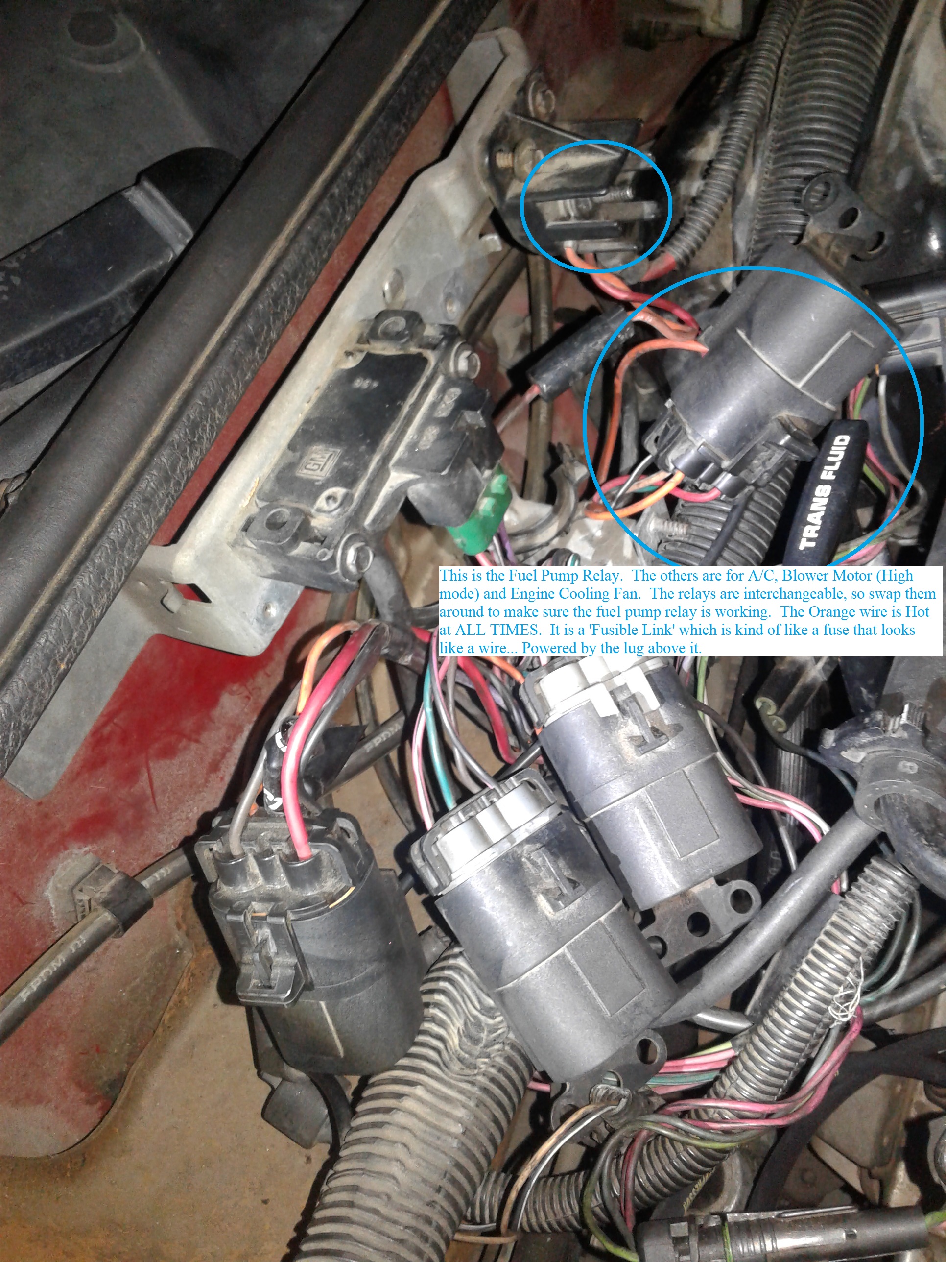

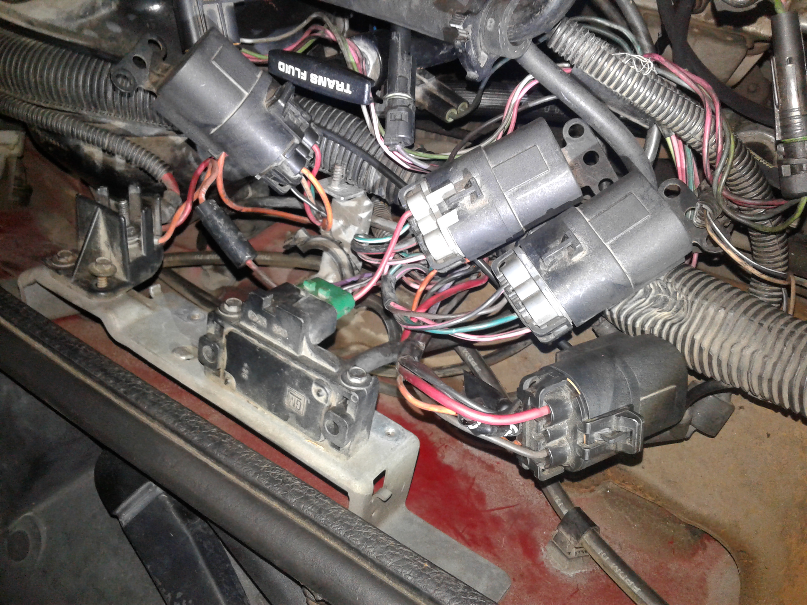

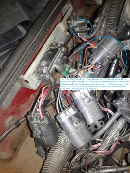

4 relays on firewall

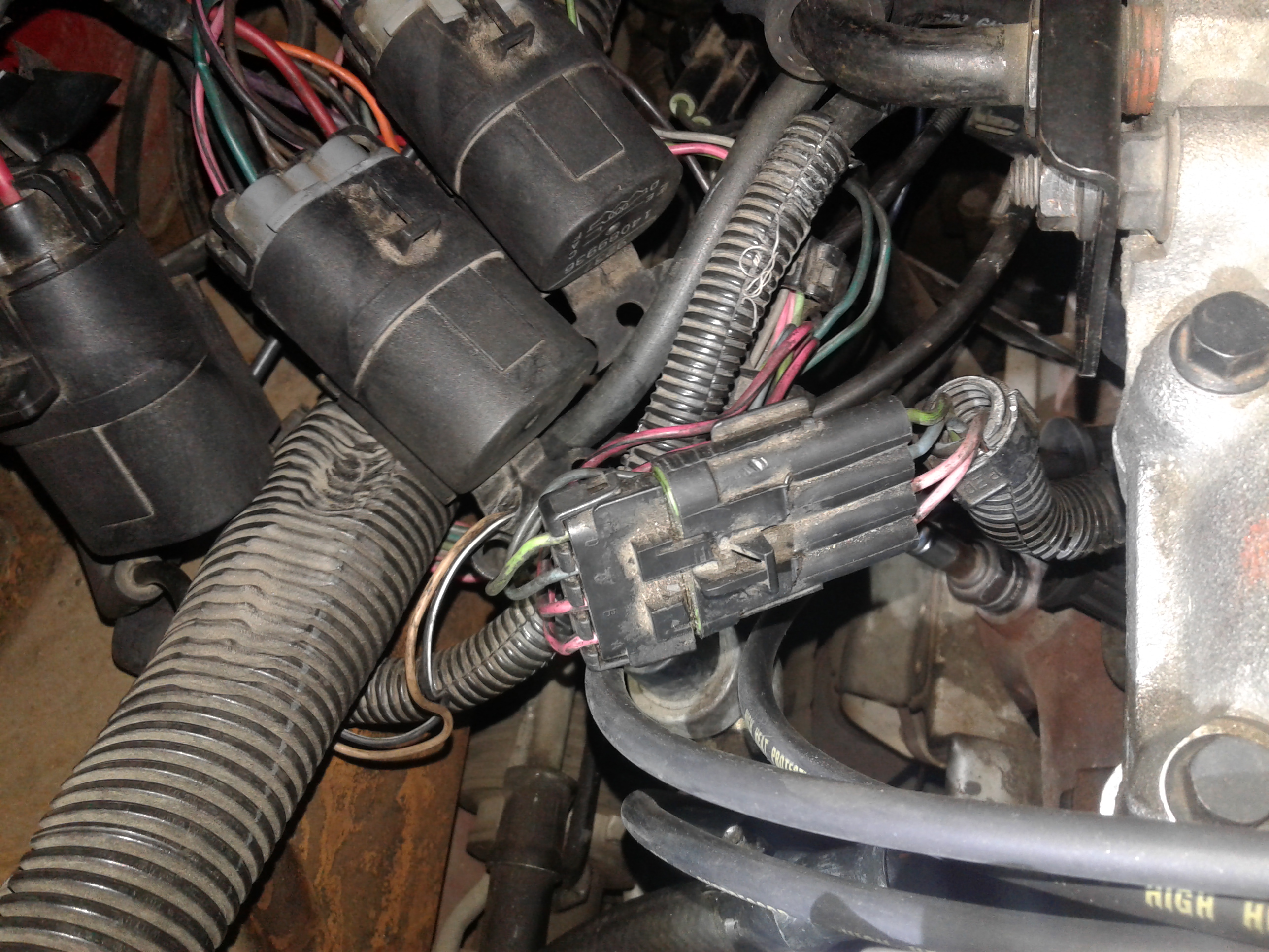

Connector to injectors

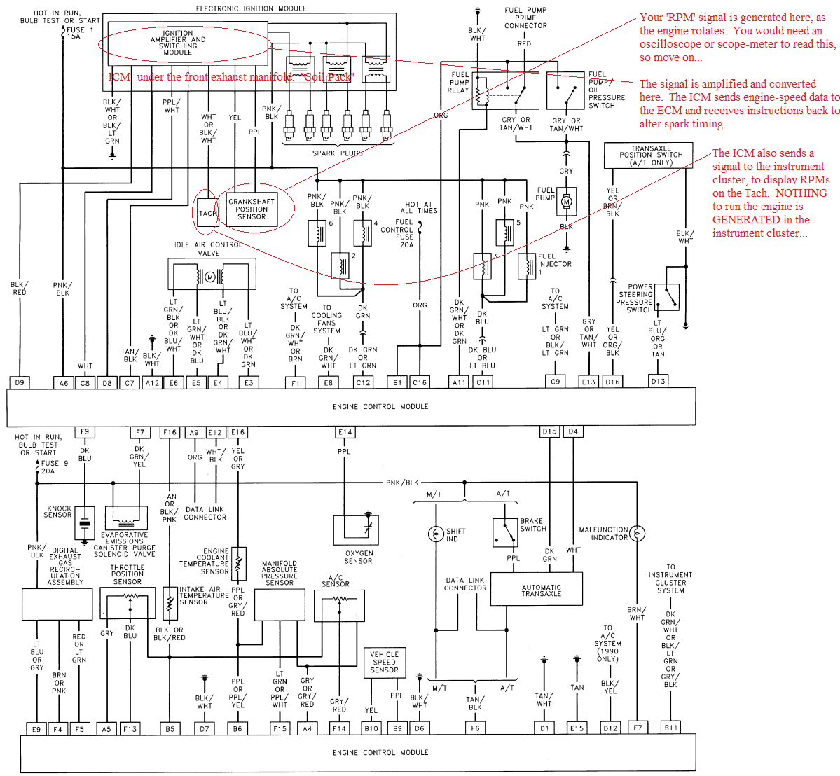

Where does my RPM signal come from??? And if anyone has wiring diagram?? And can I test injector pulse for pcm or injector connector??
Posts: 1855
Re: Need help trouble shooting
Fuel Pump Relay... PM replied to regarding RPM signal, I strongly recommend getting a Chiltons or Haynes service-manual for your car. You can clearly do the work, but without a guide to give you specifics, you are shooting in the dark, especially on diagnostics. Newer Chiltons (showing a red Corsica on the cover) have better wiring diagrams.

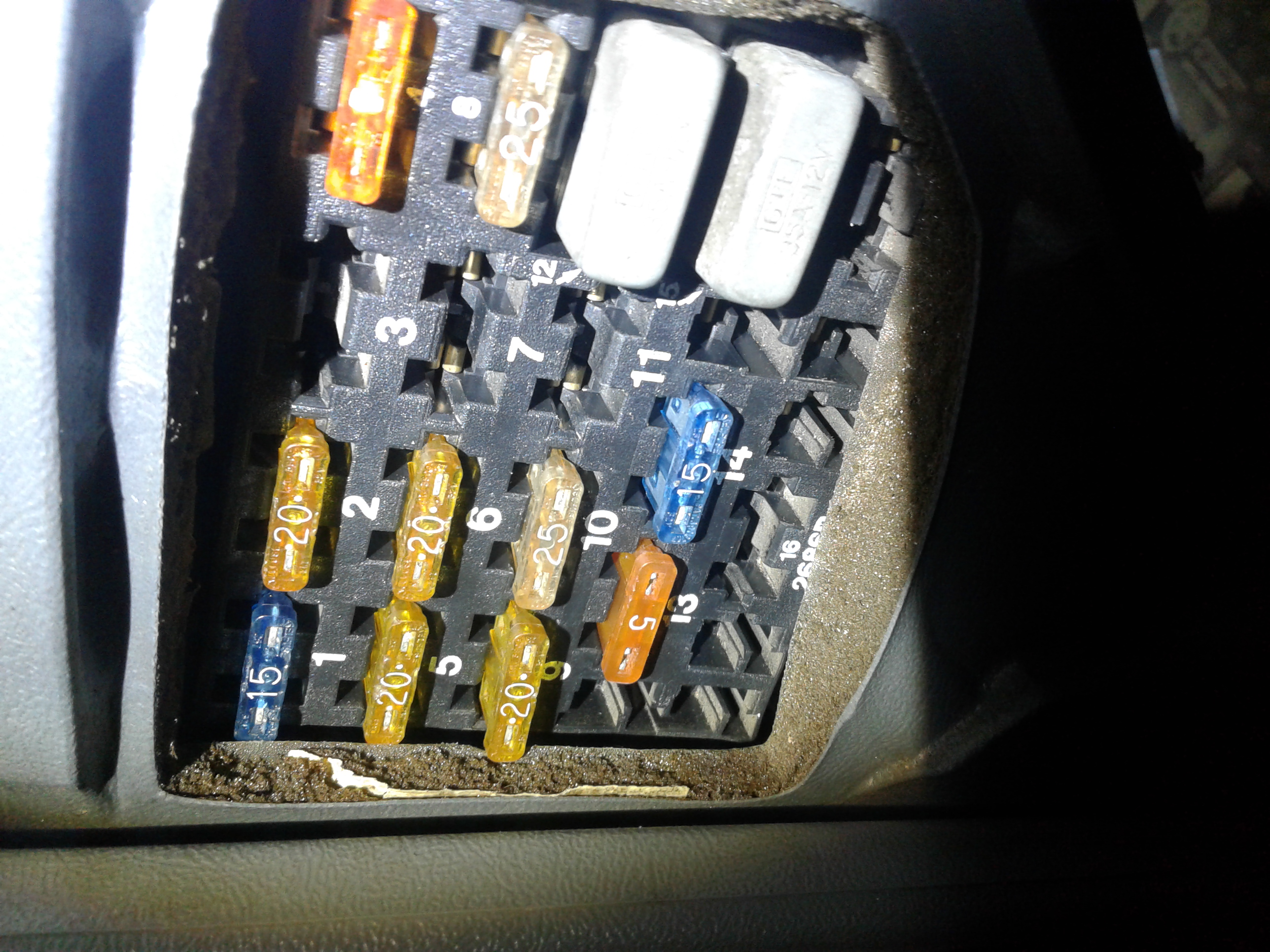

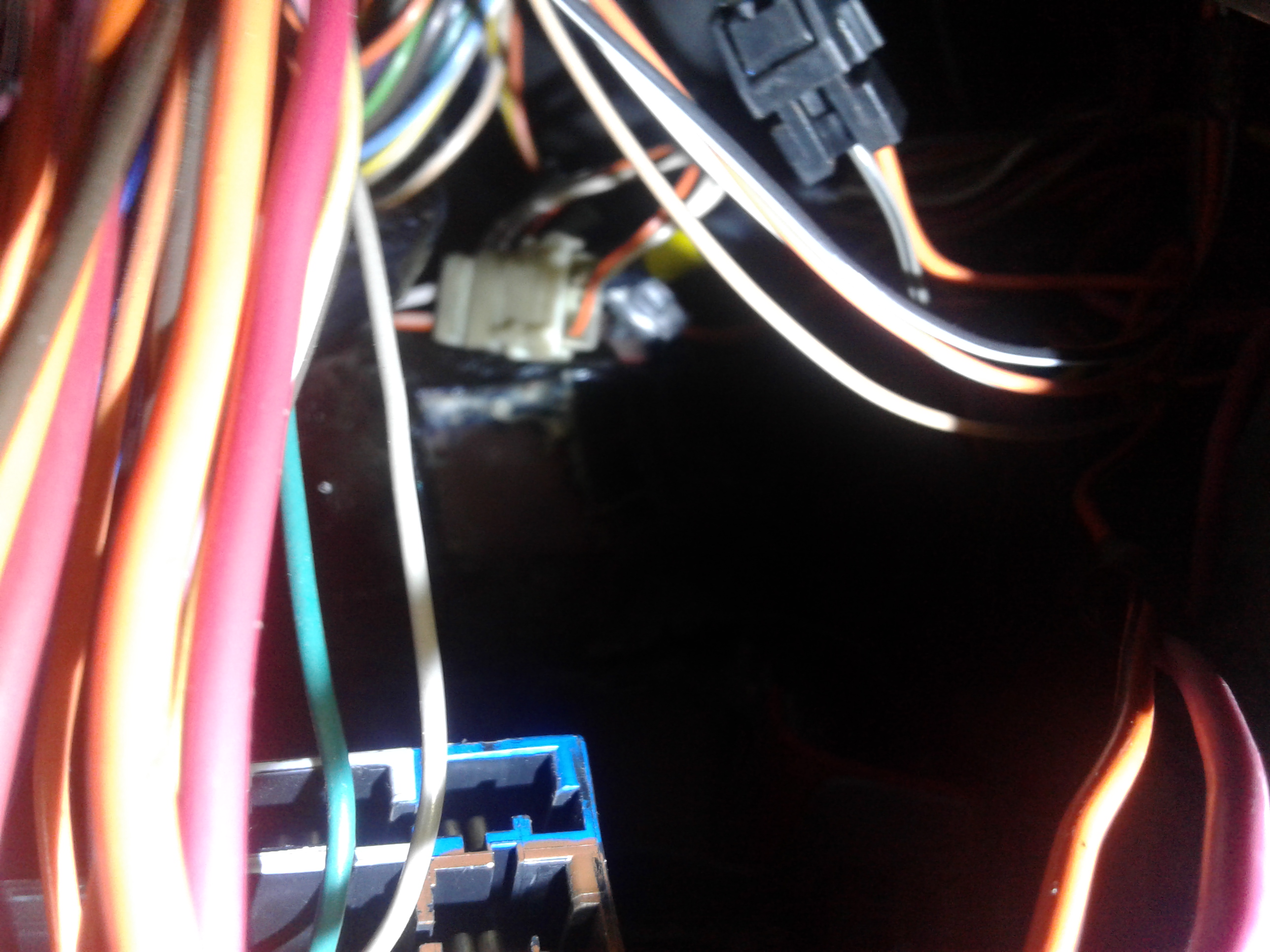

#13 in fuse panel is a 5 amp fuse when car first started problem tested all fuses this one fuse wood only work on one side until I wiggled it, now I don't get any power to it with key on or off, this Keys goes to my instrument cluster which I think is where my RPM signal is. So how would I look that up what kind of diagram would I be looking for from the fuse panel out, it's a green and a gray or white wire, where do those go?? Or come from??

#13 fuse
#13 fuse

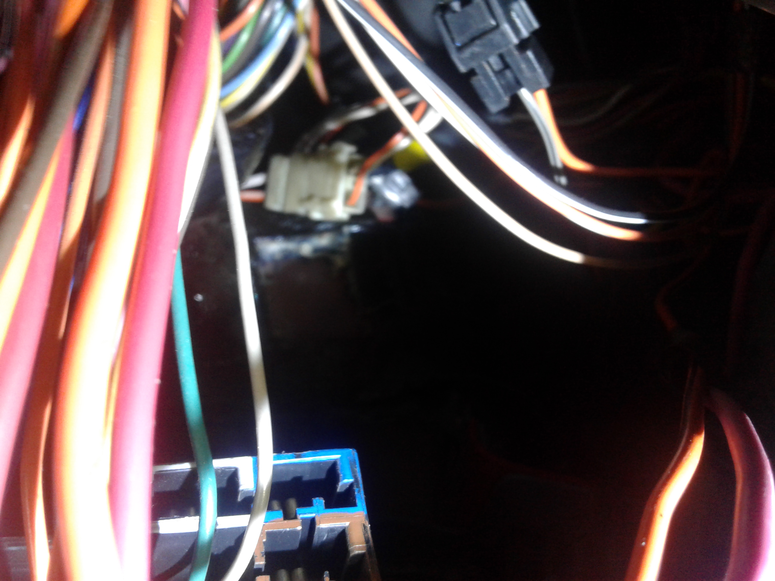

LisaMartinez
Posts: 35
Joined: Sun Sep 29, 2019 6:35 am
Location: San Jacinto, CA
Post by LisaMartinez »
Green and gray from back side of #13 fuse

This should help you figure out where and how the car gets its' engine RPM signal from. You CRK or Crank 5-amp fuse does not run anything, it simply tells the ECM you are cranking the engine over so it knows how to adjust fuel and spark trims -it should only have power while holding the key in 'start' as I recall. Removing it might make the car harder to start, it won't prevent it from starting or running though.

its none that I can unhook the fuel line after filter and go to private and gas flows out just fine and already did a gas pressure test at Schrader valve good something is stopping my fuel from opening injectors it's my crank position sensor wire that goes from nice cm to the crank position sensor

Crank signal goes from crank sensor to icm, and from icm to ecm. Test crank wires from sensor to icm with multimeter if its busted, in my corsica it was little ripped. Thats and easy test at least. Icm wiring pinout you can find from here ; https://easyautodiagnostics.com/gm/3.1L ... k-sensor-2
