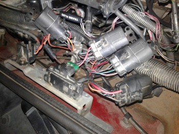

- 4 relays on firewall

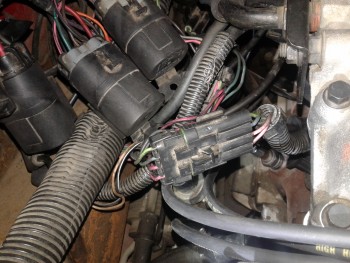

by LisaMartinez
- Connector to injectors

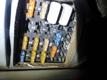

by LisaMartinez
#13 in fuse panel is a 5 amp fuse when car first started problem tested all fuses this one fuse wood only work on one side until I wiggled it, now I don't get any power to it with key on or off, this Keys goes to my instrument cluster which I think is where my RPM signal is. So how would I look that up what kind of diagram would I be looking for from the fuse panel out, it's a green and a gray or white wire, where do those go?? Or come from??

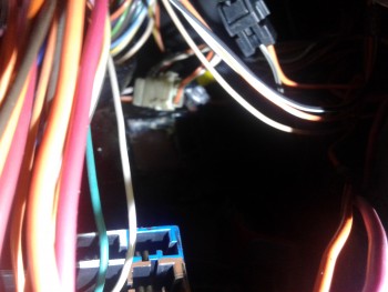

by LisaMartinez
- #13 fuse
Re: Need help trouble shooting
Posted: Fri Feb 28, 2020 3:39 pm
by LisaMartinez
- Green and gray from back side of #13 fuse
Posted: Fri Feb 28, 2020 5:39 pm
by Rettax3
Have you narrowed the problem to fuel or spark?
Okay, let's try this like a check-list:
1. -Fuel pressure at the rail, test-port shows 35-40 PSI after turning the key on and off a couple of times or 'bumping' the starter. Y/N
2. -Inline spark tester shows spark going to plugs while cranking. Y/N
3. -Noid lights show pulses at the injectors (or four-pin harness if you can get them to make good enough contact with the noid light) while cranking. Y/N
This will help pin it down into one area, and we can keep going from there.
This should help you figure out where and how the car gets its' engine RPM signal from. You CRK or Crank 5-amp fuse does not run anything, it simply tells the ECM you are cranking the engine over so it knows how to adjust fuel and spark trims -it should only have power while holding the key in 'start' as I recall. Removing it might make the car harder to start, it won't prevent it from starting or running though.
