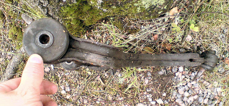

Adjusting Konis any firmer on our cars will just bend the control arms to hell and then cut your fuel and brake lines.
That's because the (cheap design) adjustment on them only changes the rebound rate instead of damping...

I guess you either have really good, straight roads or you drive like a grandmother.. i needed one year to destroy my control arms and i wasn't even running the tightest setting on them, it was something like 3/4.3400beretta wrote: I had a set of koni yellows on my old car, from 2003 till the car got smashed last year, and they were always on the firmest setting, with no ill effects to control arms or the like. They now live on the new car. However, I'd rather have, and will have a set of coilovers eventually for this car.
What causes that is hitting 2 bumps/pothole or bump/pothole on a corner, first bump\corner suspends the strut, and since it's not expanding back quick enough and stays bottomed, the next hit will be without suspension effect then and hit the suspension violently... very bad design from Koni to build it like that.. but they say, you get what you pay for.
Ever since I've been running with the softest setting on my car, no more bend control arms or cut fuel lines.
