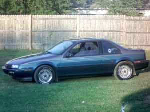

by Beretta_gal
well...Still no word on either car as of yet.....Car #2 I cranked it up this morning on a cold start,idled high at like 3500 RPM's...shut it off re-started it and then idled at about 2800 RPM's...I restarted it about 4-5 times and on the last re-start the idle was about 1500,still a bit high,but tolerable...anyway,it started right up,ran great. I let just sit and idle about 20-30 minutes,and finally after warming up I guess,it started idleing like crap and then finally died out...when I went to re-start it,it sounded like crap,and wouldn't stay running. You could also smell the richness of the fuel....I haven't yet tried ICM,as I was waiting to see if car #1 needed it and if not then using the one I bought to put into this car...As for Car #1....It's still sitting at the shop,the mechanic is testing and eliminating---sorta speak,but I did drop off a crank sensor to him to try in it,he had the fan pulled out and what not to put test/put in the new ICM....I sure hope something comes about soon....I miss my babies!!!!
Re: HELP!!! My on-going problems
Posted: Thu May 05, 2011 10:50 pm
by Beretta_gal
This is car #1
This is car #2
