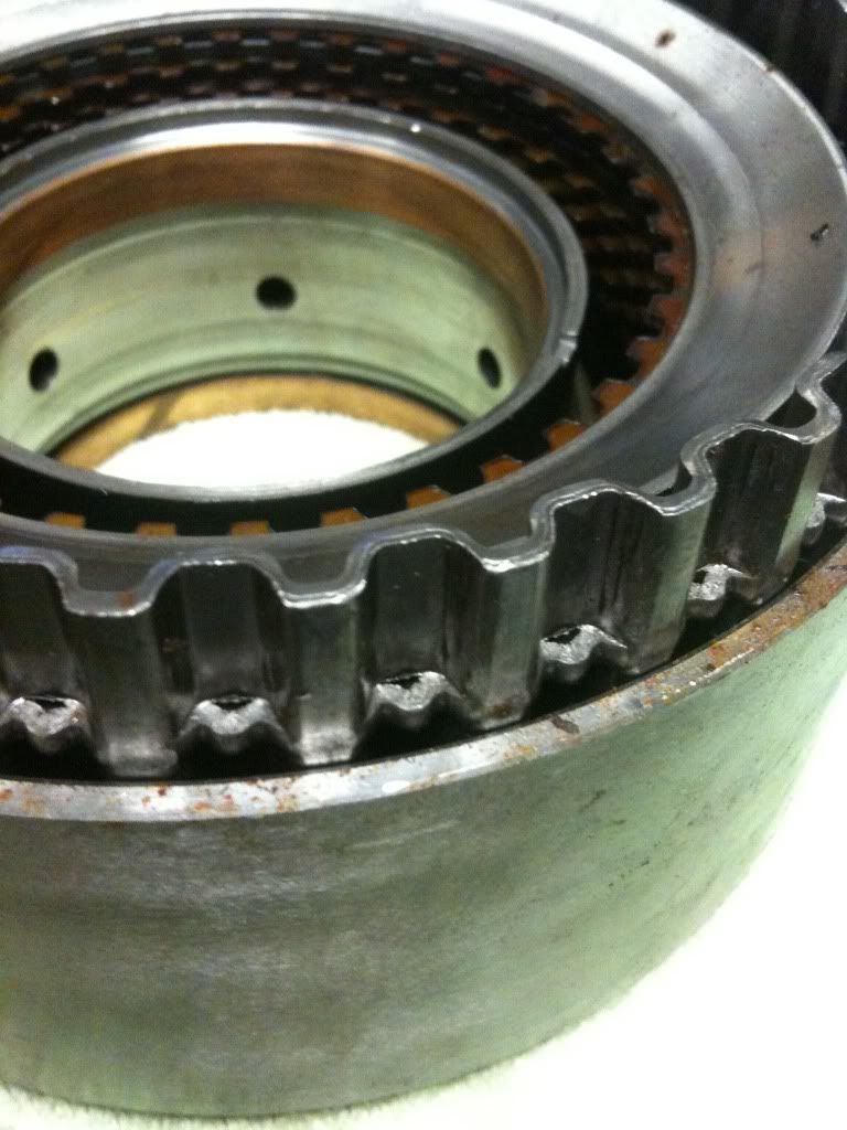

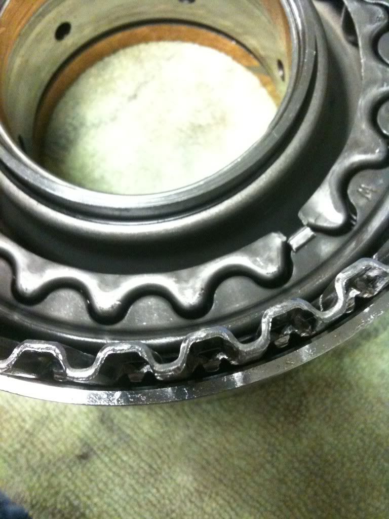

Well... some of the excess wear that I found on a few trans parts...
2nd clutch drum has wear where it interlocks with the reverse reaction shell. I'm not sure what motion causes this wear, but either way compared to my 175k mile trans this one that should only have 88k on it the amount is amost twice as much...
The spare one I did have has some wear elsewhere so I have one more trans I can take apart in hopes that I can use it's internals... after that its ebay time.
Comparison
Wearing the edge of the teeth away.
Comparison
The comparison one is worn on the center hub, so I do not want to use that because then I'll have to shim the bearings alot and I dont like to use a bunch of shims if not needed.

Re: January 2010 Project Begins (Raspberry)
Yes, the outer splines go into the 669 part, which is called the reverse reaction shell, and that has a tendency to explode in a stock trans, but mine has been replaced with a hardened version. Why?
My confusion on which motion causes this wear refers to wether or not this area has heavy pressure against it under WOT in first, second third gear, OR reverse. Just not sure which motion puts that stress there.

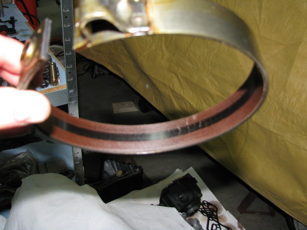

More pics of trans parts that I was not impressed with.

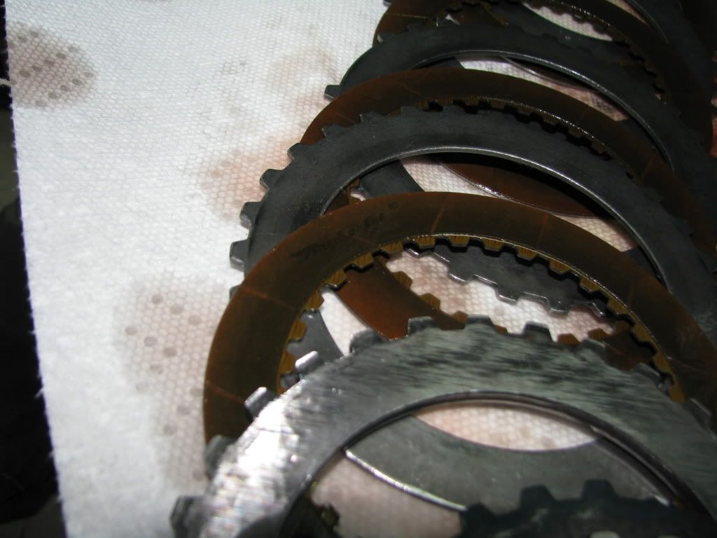

Burnt Input Clutches

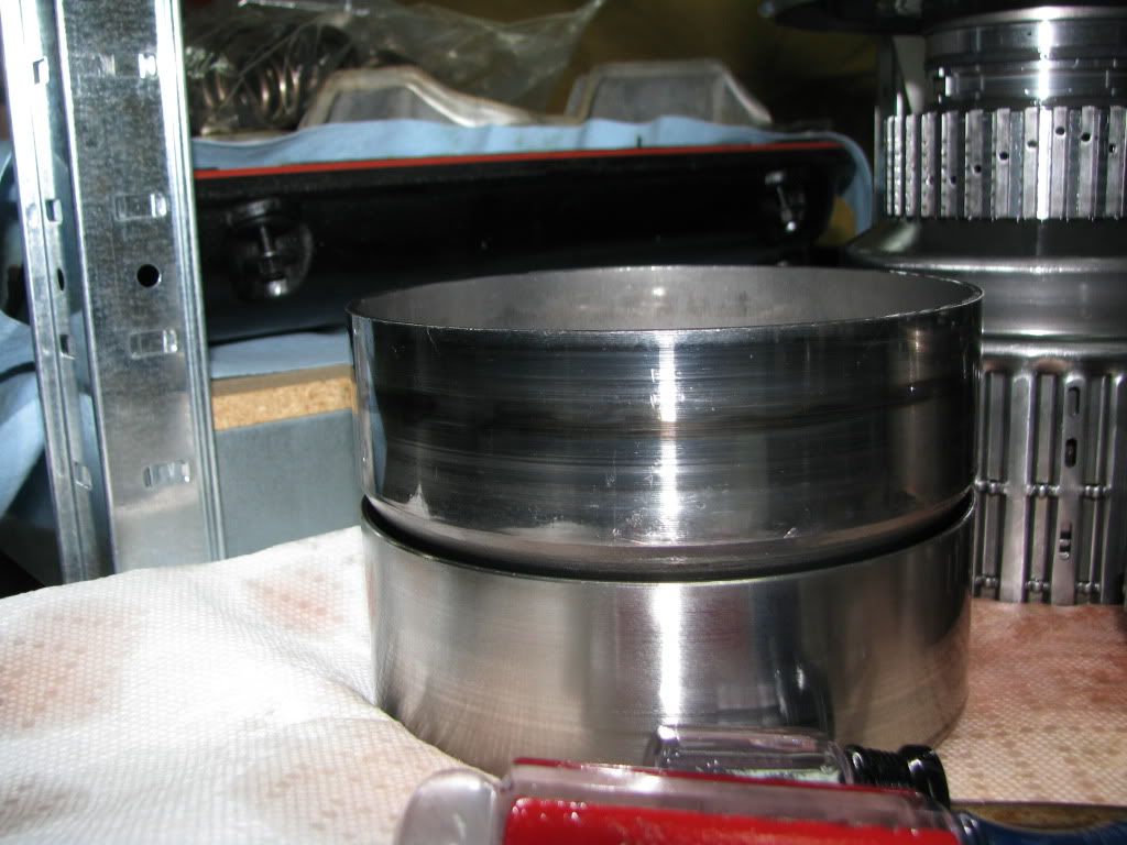

Burt 1-2 Coast Band
Heat mark on drum, This should be fine though, no suface scaring, I just need to make sure its flat.

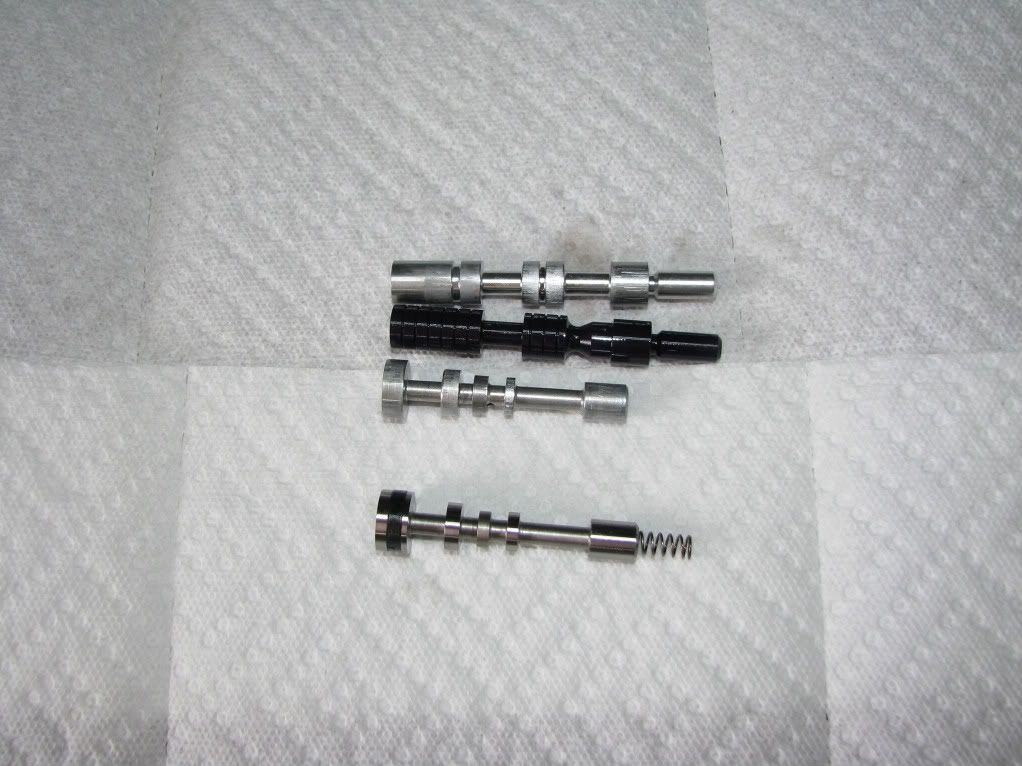

And all the scuffed shift valves next to their replacements.
New TCC valve with seal and the 1-2 anti-stick valve again.
All the valves I bought.
Burt 1-2 Coast Band
