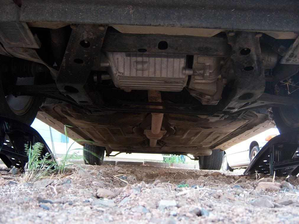

It actually mount behind the trans (closer to the firewall) and yes it does fit a 5spd. I have one on my car. Geoff do you have any pics of the one you're talking about fabbing? The stock piece is light duty...Money pit Beretta wrote:I have the STB and the frame brace. How do I say this...the frame brace fits with the 3T40, but not the 4T60 and I'm not sure if you can use it with your 5sp. It mounts in front of the trans on the frame. Someone else will have to chime in on this.
Edit: here's an old pic to show the brace.
Re: 1992 Quasar Beretta GTZ - Top end swap in progress. Upda
When I finally get 5 min to look at it, I'm planning on making one as well. Should be rather simple to make up one.
Thanks Woody, nice pic!
3X00 I can't wait to see yours for the 4T60.

This is the only pic i have of it at the moment. I will try and get a better one later on
Its a lil hard to see but if you look closely you will see the round stock welded to the bottom of the stock support.
I see it. Man you got to look hard.

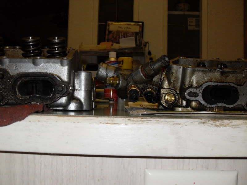

Twas a late night for me. Got some jobs done today and some errands, picked up the last of what I need to get the car back together and picked up my valves and AWESOME shape new fuse panel cover at the post office.
So , yeah, I'm STILL up and posting before I hit the sack. I'm going to bed very shortly! And I'm sleeping in!
Thanks to Geoff (90gtzho) and Shawn (Summitbalt08) respectively!

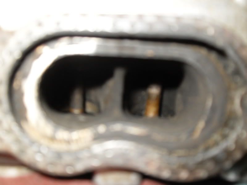

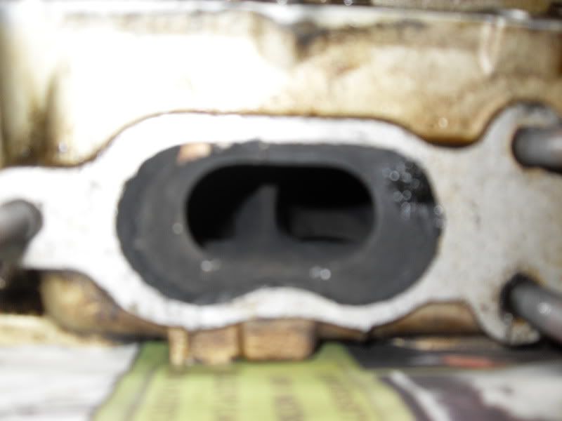

First things first. For those of you who are "Quad 4 challenged" or just didn't know and had asked why swap to an 086 and what are the differences when compared to an 086 , what gains, etc. Below are side by side pics of the 086 I'm putting on and the 456 head I took off, exhaust port side. I think the pics will speak a million words, but note the HUGE port size difference.
The 456 is on the right, the 086 on the left.
The second pic is a close up of the 456 port and the third pic is a close up of the 086 port.
