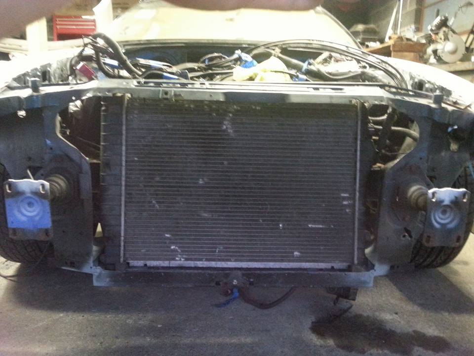

progress has been a lil slow lately. ment to post this awhile ago. or thought i did. Got the Beretta lower rad support/core support notched for the drain and fan shroud and dropped it down about 1.5 inch to make room for the camaro radiator and dual fan setup..... just gotta make a top bracket and should be set..

Are you going to leave the angle iron on there after you weld the body to the floorpan?
For that lower radiator mount - If you have any C channel - cut it at 45* on both sides to form a triangle and weld it in to reinforce it being lowered - should make it stronger.

Yeah ...angle iron will stay. Thats what bridges the gap between body rails and inner rocker and supports the body......and good call on the lower rad support piece ......I thought about doing somerhing like that but figured that it was good enough for now.
